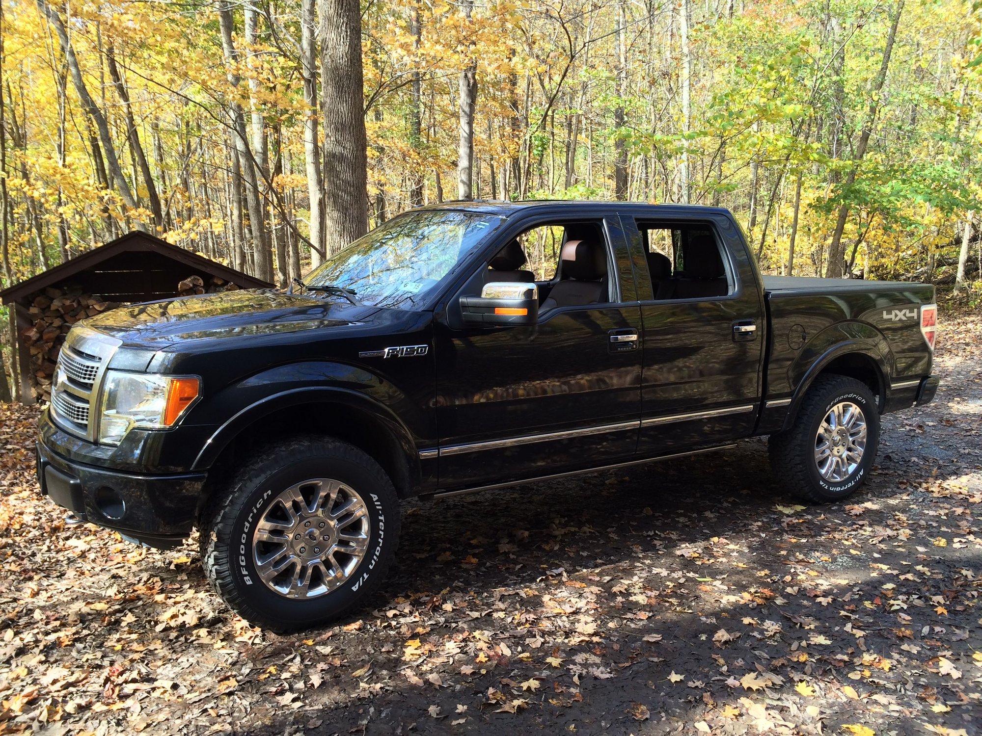

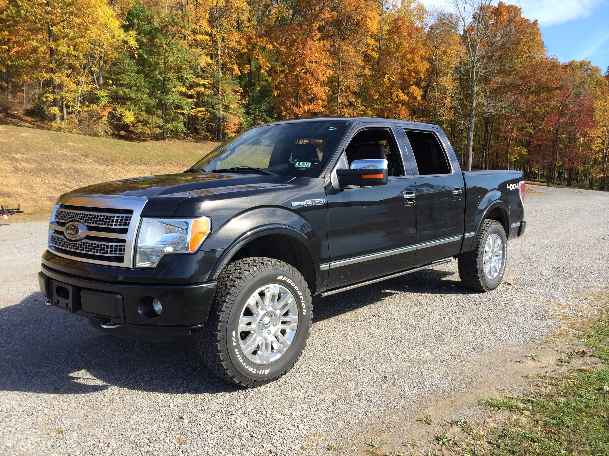

Don't know about parking garage but I have a 2012 Screw Platinum and a AS 2" level sets pretty level I definitely think a 2.5" would be too much.
