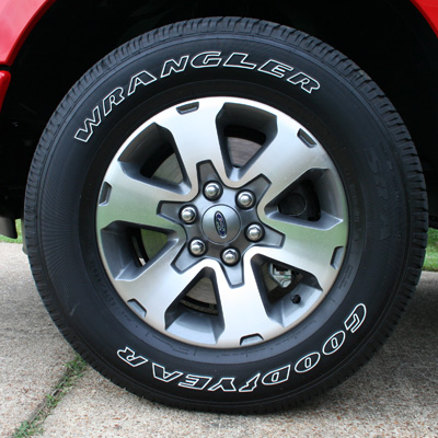

These are the wheels that came on the truck. They are 18 inches in diameter and that really limits my tire options. According to a good friend and fellow Jeeper that runs a tire store, the 2013 F-150 STX 4x4 was also available with 17 inch wheels. 17 inch wheels really opens up tire options and reduces the price dramatically!
I checked with Ford, the dealer, and several forums but have not been able to find out what the backspacing on these stock 18 inch wheels is, nor have I been able to find out how large/wide of a tire I can stick on them before I have rubbing/clearance issues.
1. Does anyone know what the backspacing on these are?
2. Can I get some advice on tire sizes that I can mount without encountering rubbing/clearance issues?
I run BF Goodrich Mud Terrain KM2's on my Jeep, but KM2's for an 18 inch wheel are $449 each
Thinking of trying to find the 17 inch wheels from Ford (if they're alloy) and seeing if I can get a set cheap or someone wants to swap their 17's for 18's.

Nice looking truck! Those stock wheels of yours are an 18x8 with a backspacing of about 6.25" I believe. With a 2" level you should be able to run 33x12.5x18 or a metric size that will be less than a 35x12.5. Really depends on if you want to go AT or MT as the lugs of an MT will be closer to your upper control arm.
I need to run mud level tires like the BFG KM2's or Firestone Destination MTs.
I have the KM2's on our Jeep and love them as they behave really well on pavement at highway speed and still bite earth off road.
The Destination MTs look similar and have a decent treadlife.
Looks like I'm going to have to find someone to buy these wheels and swap out to a 17 with better backspacing.

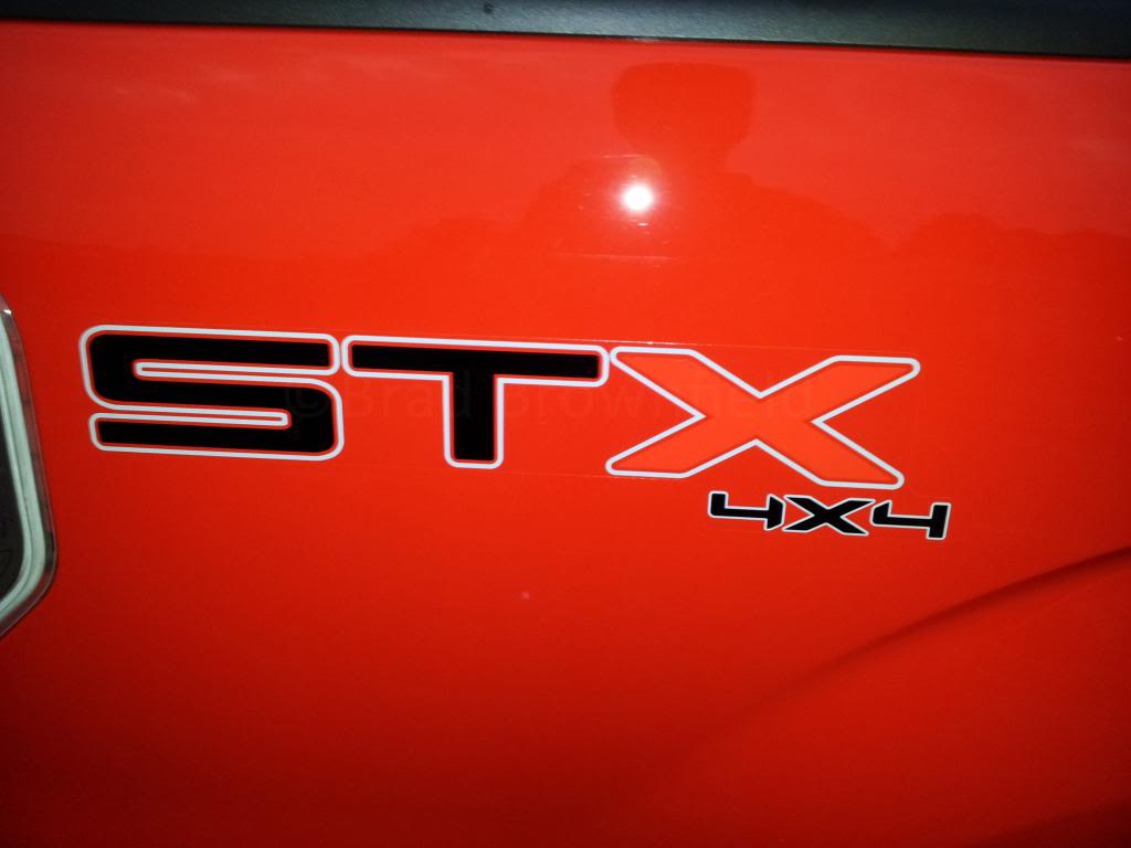

I've been reading about how the big decals on the sides of the bed will start to look bad after a while. I've seen older trucks with decals like this (4x4, Z71, etc.) that look like crap as soon as 12-18 months later. Our truck is red, so if I'm going to remove these I should do it now so there won't be an issue with the color underneath them not matching the rest of the truck if I do it later.
I already removed the dealer's sticker by peeling it off with my thumbnail and using rubbing alcohol to remove all the left over adhesive.
What is a good way to get these off without damaging the paint? I know it's a fairly popular thing to pull these off and want to know how others did it? Will the rubbing alcohol trick work with these factory stickers???
Completed the First Modification to the F-150 today!
Now, keep this under your hat- I've heard that mods will void the warranty- LOL
It's about 75 degrees outside today, with very high humidity.
With the reputation that red paint has for fading, I figure now is the best time.
We don't really like them anyway, so off they come. I started out using the oldest tool known to man- my thumbnail. I got the corner of each decal started-
Then SLOWLY peeled it off-
A little 91% and a cotton cloth to remove any left over residue- and there really wasn't any other than right where I used my thumbnail to get the corner started.
Smooth baby, smoooooooooooth-
