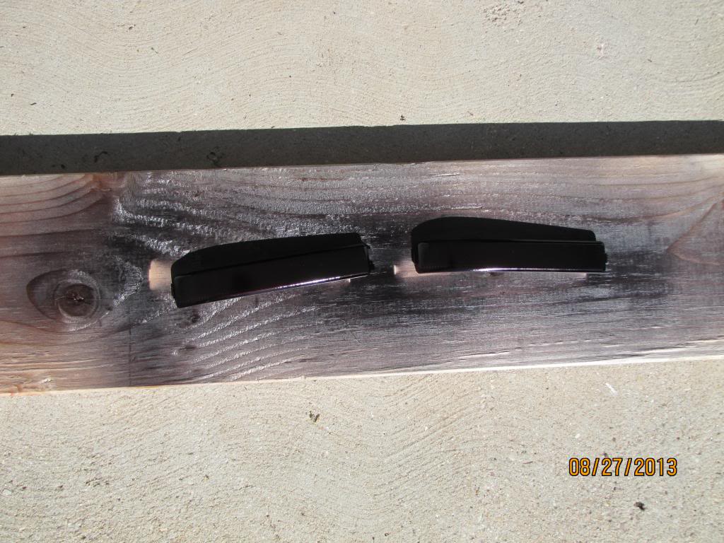

I didn't like like the reflector orange so I painted them with 2 coats of "Night Shades" tinting spray paint, and 3 coats of "Clear Coat"
