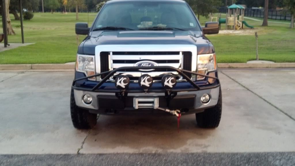

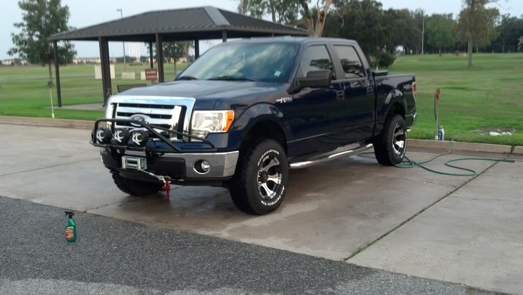

im not sure how much of a difference it is but i went from a 17x8 to a 17x9 rim with no offset. im running a 285/75/17 tire. and mine only sticks out maybe 1 1/2".

That looks great! Thanks for the pics.

no prob. if you do it i would suggest some fender flares later down the road. not only to keep the rocks from chipping paint but when i rains the rear tires like to fling mist up onto the sideview mirrors and makes it hard to see. good luck!

Hey , jooman what size kc lights are those? I bought the same prerunner bar, still waiting waiting on it to get here though. Trying to decide how big and how many lights i should put on it.

Mine are +18 on 20x9's link for pics in sig... They sit about the same as his 8's with 0... so a 0 would sit 18mm farther than mine do...

they're 6" daylighters. if i remember right NFAB says you can fit up to 3 9" lights on their pre-runner bar. i would have gotten bigger ones but 2 of them are from my last truck so when i got this one i just got a single one to put in the middle. it kinda looks awkward if you only have 2 on it.
