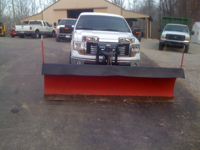

150xlt's Avatar
Posts: 412
So what u guys are saying is that a 9ft Western Pro Series was to much for my 2010?

Old Sep 1, 2012 | 07:37 PM
06yz250f's Avatar
Posts: 6,657
You have hydraulic steering.
I have no doubt the f150 will plow well for personal use, but the fact they say the electronic steering is too week scares me as they should know chances are people will throw on larger tires, ranch hand, winch, etc or even a plow thru aftermarket options. I'd expect for a front end to handle a 1000 lbs added to the front.
If how I am perceiving it is correct, I will not be happy with ford come the time i hit 120k miles and have a worn out steering system. Makes me wonder why we didn't get a hydro-assist set up instead of full electric for ease of steering.
