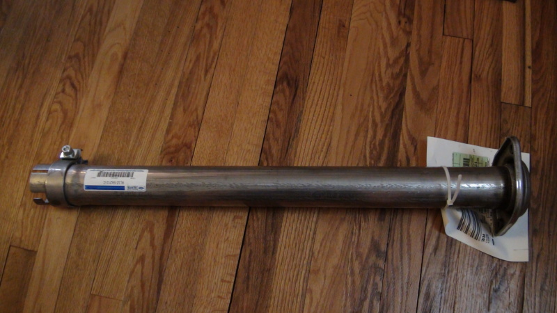

I removed the resonator on my 5.0 and replaced it with a straight pipe Ford used for the 09+ 5.4. It's a direct fit and may be a good match for what you're after. Absolutely no drone climbing hills or cruising on the highway. If you're looking for something slightly louder than stock you might want to try it.
All the info was found on another forum, here's the part numbers:
9L3Z-5A212-A - 126" wb with ex. pipe extension (chrome tip)
9L3Z-5A212-B - 133" wb without ex. pipe extension
9L3Z-5A212-C - 145" wb without ex. pipe extension
9L3Z-5A212-D - 157" wb with ex. pipe extension
9L3Z-5A212-E - 163" wb without ex. pipe extension
9L3Z-5A212-F - 145" wb with ex. pipe extension
9L3Z-5A212-G - 157" wb without ex. pipe extension
The pipe extension is for trucks with the chrome tip, those trucks had a weight on the pipe to offset weight and prevent vibration. Here's a pic of the 145" without pipe:

Hey Scorpio,
Can you elaborate on the pipe extension some? I have a crew cab 5.0 and would like to get rid of the resonator for a louder sound. I do have the chrome tip on my truck.

Hey Scorpio,
After locating the other thread in which you posted videos I believe I know which pipe I need. I have an FX2 and it has the chrome tip with the 5.0 Screw. Looks like it'll be part#9L3Z-5A212-F. Truck sounds good with out the resonator. Any mileage difference?
