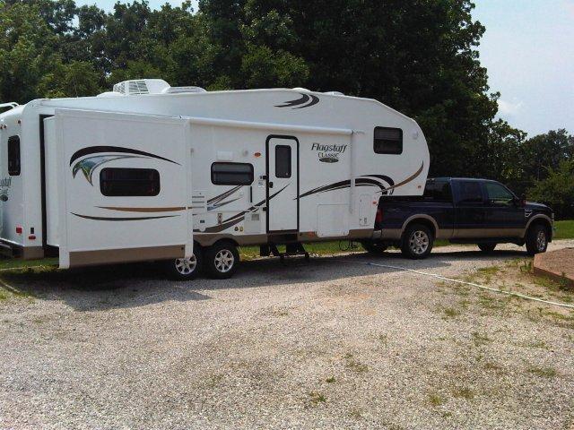

fordmantpw's Avatar
Joined: Jul 2002
Posts: 1,550
From: Linn, MO
No room!
