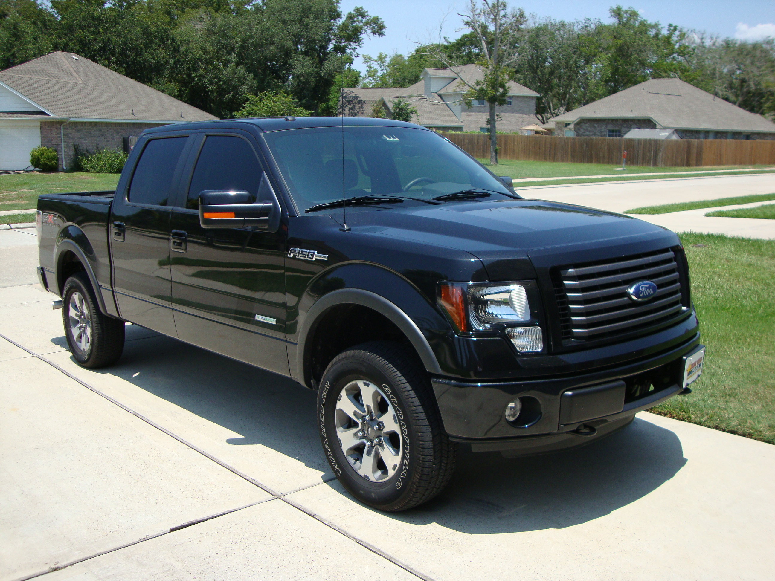

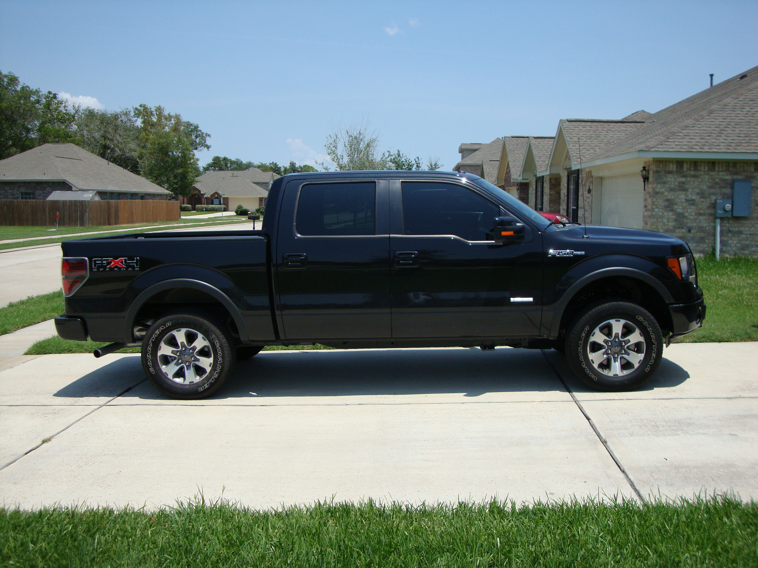

A couple pics of it with the leveling kit installed before the new wheels/tires go on.....(sorry the truck is completely filthy due to rain this week)
Looks to be sitting a bit nose high to me but.... I just remeasured and its basically 39" from the fender trim to the ground on all fours so....it measures out level but it damn sure looks higher in the front to me... I am hoping it drops a bit after the alignment...otherwise will do an add a leaf.
It's the optical illusion of having the front wheel opening to be more oblong (larger in some areas) than the rear wheel opening in order to allow more clearance for the front tire to accommodate all possible turning angles and articulation. Look carefully at your own photo of the truck's profile and you should be able to see the difference in shape of the wheel openings...
