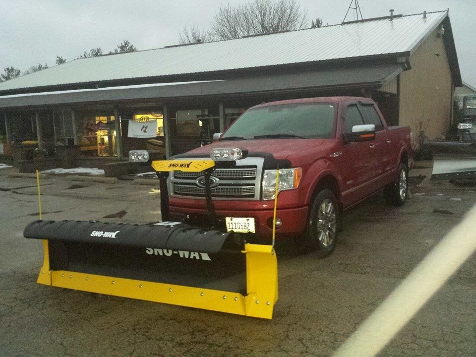

OK, took a couple pics of the truck with the plow on today. Not the best quality because I took them with my blackberry, but they show it. The front drops maybe 1/2" when the blade is lifted. Let me know what you think.

It looks nice! How much modification did they have to do to your truck to get it installed? Are the plow lights hooked into your fog lamps or are they a seperate switch?
It looks just the right size for the F150. Unfortunatley now all you need is a little snow so you can try it out.

The installation of a plow is really pretty easy. It's mostly plug and play. It hooks into your parking lights and your head lights with a series of plugs that match the plugs on your truck. Only one small hole has to be added thru the firewall for feeding the plow controls thru to your dash (or fishstick if it's a Fisher hand held control).
The only true modification to the truck is removing tow hooks and cutting notches into the plastic air dam to provide clearance for the frame mounts.
The set up looks good. I never noticed the built it back drag feature, that and downforce will certainly help clean up the snow by the garage.

Nice setup.
Your truck looks great.

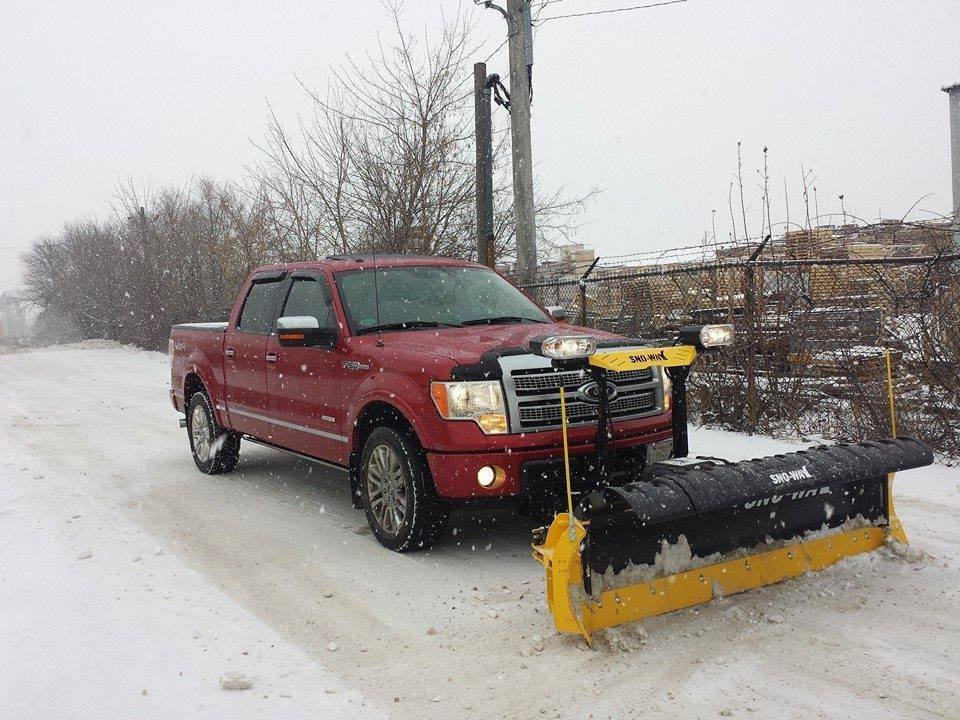

I have a 2012 F 150 Platinum with a Sno way 26 R Loves it works great but you need to put on good tires I just put on bfg TA KO2 and are great and now I just need a level kit on it because of the height of plow and need more clearance but if you go with a bigger tire too then it be hard on the transmission.
