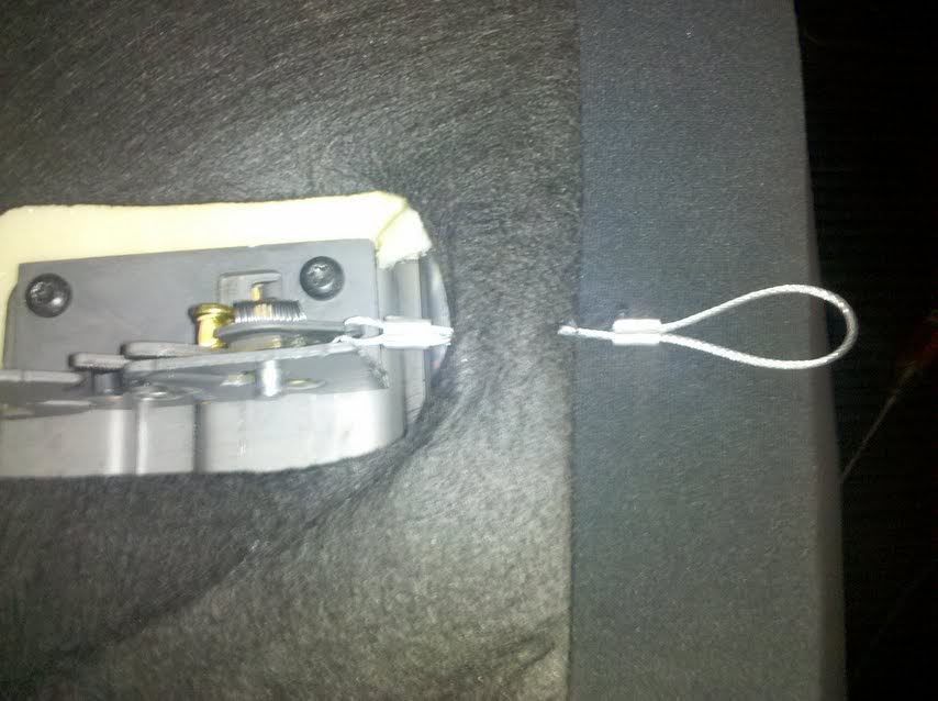

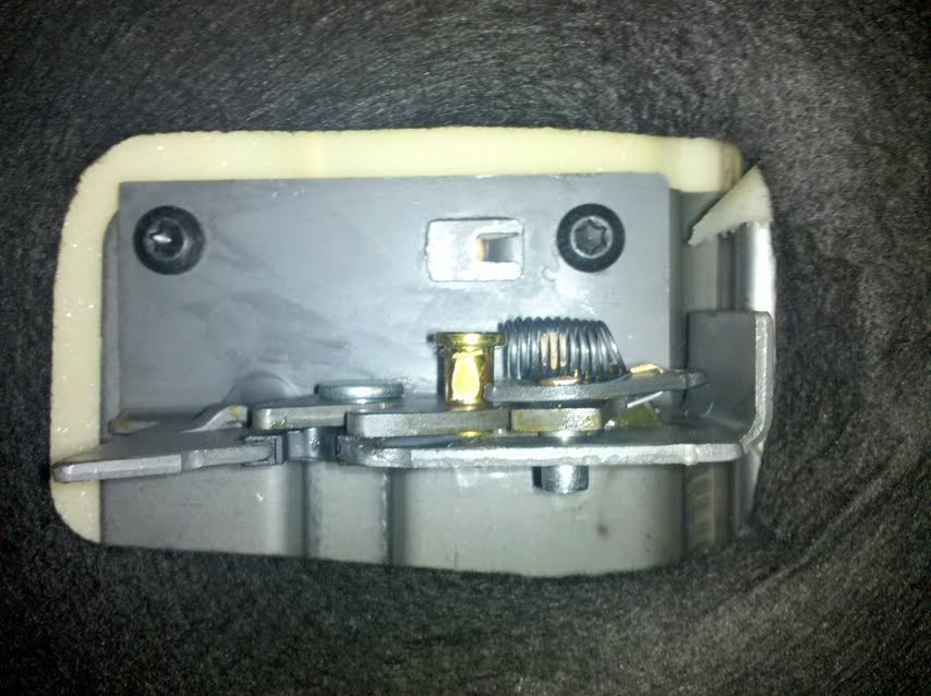

Well i finally spared five minutes for the seat latch mod i have had in mind and it works great.
Items needed:
about 18" of 1/16" aircraft cable
four 1/16" cable crimps
Tools:
torx bit and ratchet
band saw, dremel tool, pneumatic cut off tool or similar
Remove the seat latch from the seat
clamp into bench vice if using anything other than dremel

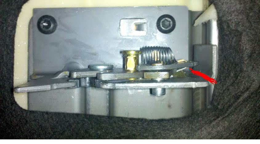

cut 1" tab off of the top of the latch bracket (marked by red line in second pic)
run cable through return spring hole, cinch down, and crimp
cut small hole in fabric above latch
run cable through hole in fabric
make loop, place crimp on cable, crimp and trim extra off.
repeat for other side.

Some people will never use the room behind their seat but i am about to build an amp rack that will hold everything. It would be a great place to store jumper cables or other stuff you hope you don't need everyday.

if you have the sliding back glass you can open the glass so you can stick the top of your head out and get a better view behind the seat. the passenger side was easy, you could pull it with your finger but the driver side was much tougher. I used the cable to stick back there and "rope" the release lever, then was able to pull on the cable.

I think i am going to redoux it and place heat shrink from one crimp to the other. just leave the loop out of the heat shrink just to make it look neater.
