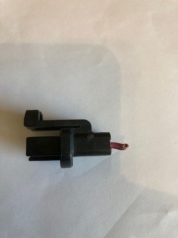

Hello,
Need some help on this one. I had an issue with a mouse/rat eating some of the wiring on my truck, 2004 FX4.I had a no start/cranking condition. Found issues by the battery. I have replaced the vacuum lines going to the solenoid. Ground wire wire eaten through, Had to splice in a new wire going to the firewall gnd. That fixed my no start. But the wires on electrical connector that connects to the solenoid are to short for me to splice them back.
Does anyone know the connector part number or even what it is called?
TIA,
Dannyo

Hi,
Maybe WPT-441?
Check out the cool catalog.
MK
Wiring Pigtail Kits Identification Guide | Motorcraft
Amazon.com: Motorcraft Wiring Pigtail Kit : Automotive Amazon.com: Motorcraft Wiring Pigtail Kit : Automotive

The pigtail kit one looks to be correct. Will order and try it out.
Thanks MKTRUCK!
