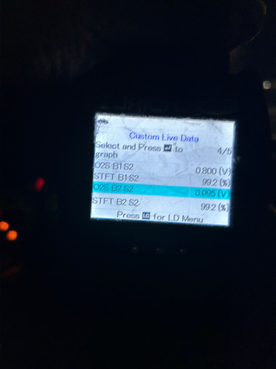

Ok i used my scanner and it looks like there’s an issue with bank 2 sensor 2. Bank 1 sensor 2 seems to be function fine. The bank 2 sensor never gets over 500 and it fluctuates rapidly

This is a live data reading

Bad wiring or bad sensor. It shouldn't affect the way it runs, the downstream sensors are only used for cat monitoring.
