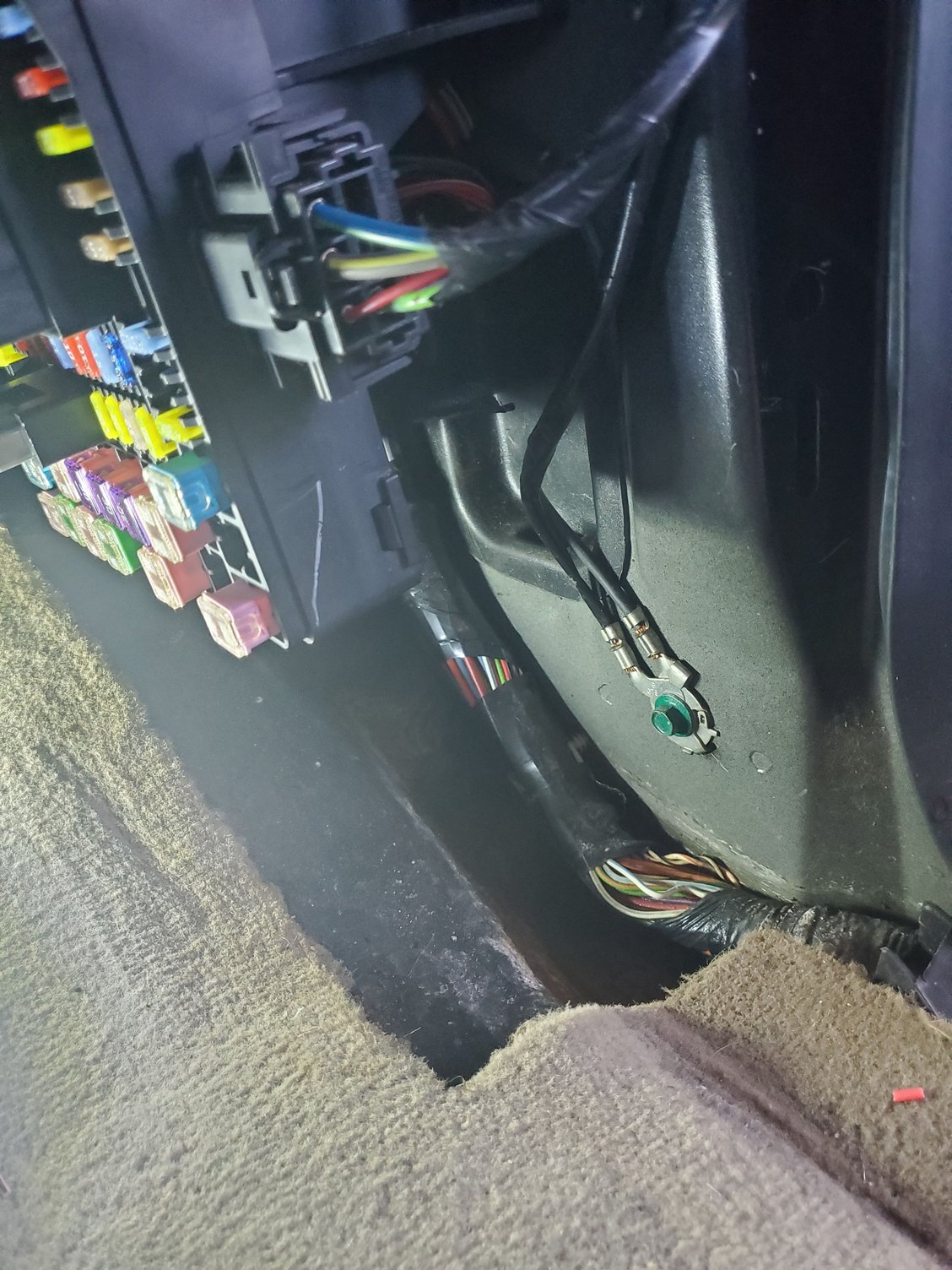

Here's a photo of the three grounds on the passenger side of my 2004 Lariat after removing the plastic covers. The one on the driver's side is in a similar location.
Are you locking and unlocking with a remote control? If so you might want to wiggle the black rubber wire boot between the driver's door and the body to see if it affects the problems.
