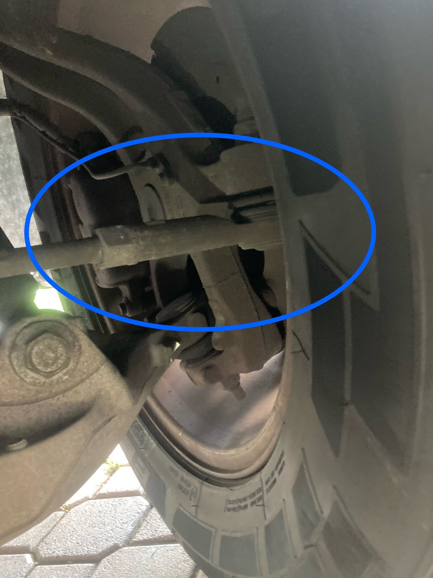

I recently got two new tires and the guy had the truck lifted up front and started shaking the wheel and said that it was a problem that there was movement. Another guy pointed it out to me the part that needed to be changed but didn't say what it was called. I told them id get it done later. Anyone know what this part might be and if it's an easy job? I believe it's the part circled in the photo if I remember correctly.

Tie Rod
Here, this might help:
Old Jul 31, 2023 | 04:38 PM
Posts: 43,538
That's the outer tie rod he has circled. Alignment will be required, I'd take it to a reputable front end shop and get everything checked.

Does play in the wheel mean it's definitely the outer tie rod? There's play in my front passenger side wheel but not the driver side.
Old Aug 3, 2023 | 10:18 AM
Posts: 43,538
No, it has to be looked at by someone who knows what they are looking at.

my mechanic took a look and confirmed its the outer tie rod that is causing the play. Is Delphi a good brand for outer tie rod or should I pay more than double for the motorcraft? Another brand?

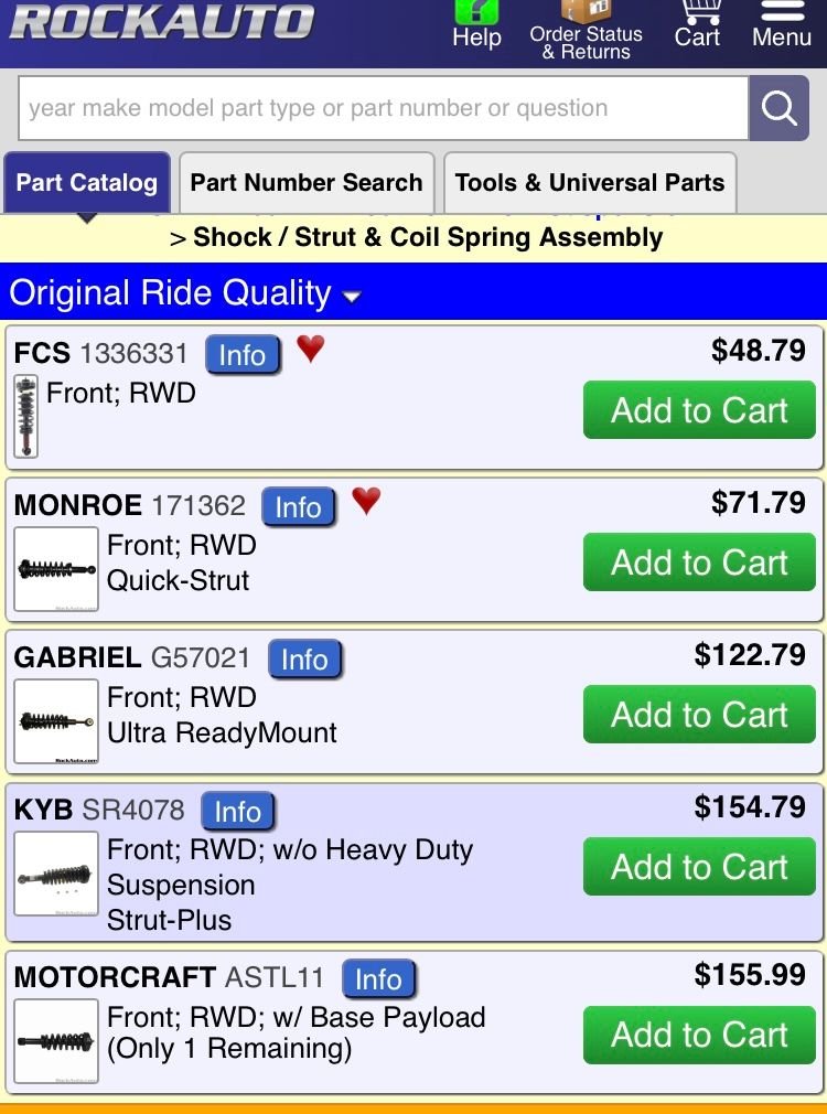

Thinking of changing the front struts at the same time as the outer tie rods. Couple questions, how important is getting 350 ft lbs of torque on that lower bolt as my torque wrench only goes to 250. Should I bite the bullet and get a bigger wrench? Also which strut is best bang for buck? Thanks.
Old Aug 21, 2023 | 09:28 PM
Posts: 43,538
I'd say that the Monroes would be the most cost effective.
Old Aug 22, 2023 | 09:45 AM
jr105's Avatar
Joined: Sep 2004
Posts: 336
From: Groton, MA
Due to a broken coil spring I installed KYB quick struts in the '04 I had. They had a better ride and the truck sat about an inch higher than with the OEM struts. Very happy with them.
Old Aug 22, 2023 | 10:16 AM
Posts: 43,538
Are they worth twice what the Monroes cost?
Old Aug 22, 2023 | 02:45 PM
jr105's Avatar
Joined: Sep 2004
Posts: 336
From: Groton, MA
To me yes. I haven't had good experiences with Monroe products.
