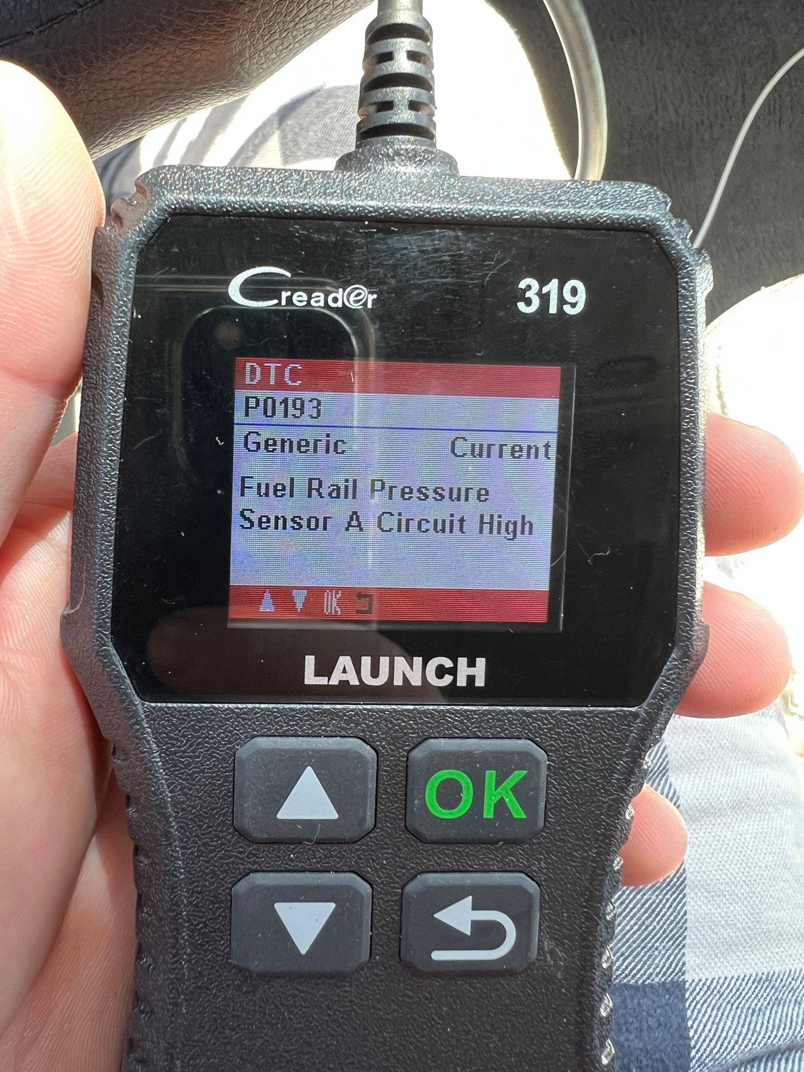

I replace the driver module also but yesterday gave me a check engine light
P0193 I replace the fuel pressure sensor

yesterday I took it to auto zone cus the check engine came on and it show that it had P0193
Old Apr 8, 2023 | 04:30 PM
Posts: 43,538
Symptoms of a P0193 engine code may include:
Malfunction Indicator Lamp (MIL) illuminated
Lack of power
Engine cranks but won't start
Potential causes for this code to set are:
FRP signal short to PWR
FRP signal circuit open
Damaged FRP sensor
Read more at: https://www.obd-codes.com/p0193
Copyright OBD-Codes.com
