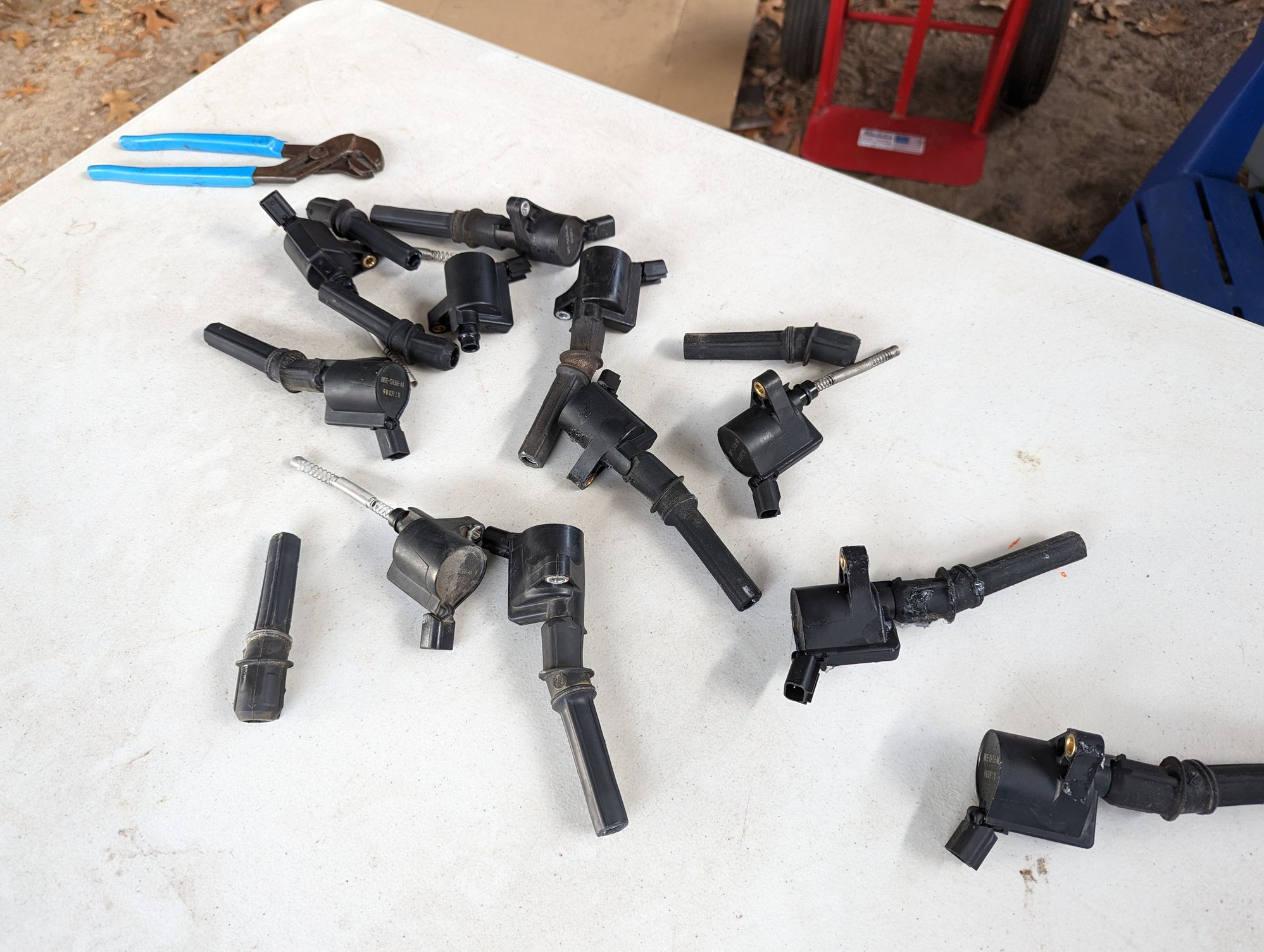

I got taken on eBay for 8 DG508 ignition coils last November in 2022. I only realize now that $181.89 for 8 genuine Motorcraft Ignition Coils should have alerted me, but I completely ignored this warning. I installed 7 out of the 8 coils as soon as they came and they did function.
Feeling fairly confident and just carrying along as usual, I ran along a post on a forum on the Internet regarding counterfeit Ignition Coils. The post said to be on the lookout for counterfeit ignition coils and gave tips to spot them by the packaging. But my first thought was that I was too smart to get taken but I began to look closer at what I bought.
Packaging: None of the things I read online appeared on these bags. The Motorcraft bags were sealed, had the vent holes in them and so on. So, after all my research the packaging was perfect and to me qualified as deep fakes. The coils themselves were much more suspicious. A brass ring where the bolt goes in to secure the coil instead of a silver one. No paint mark on the top of the coil and a spring inside the boot that seem a little to short and not secured well to the metal tab at the top of the boot. About half of the springs just came off their terminal at the top with the slightest tug.

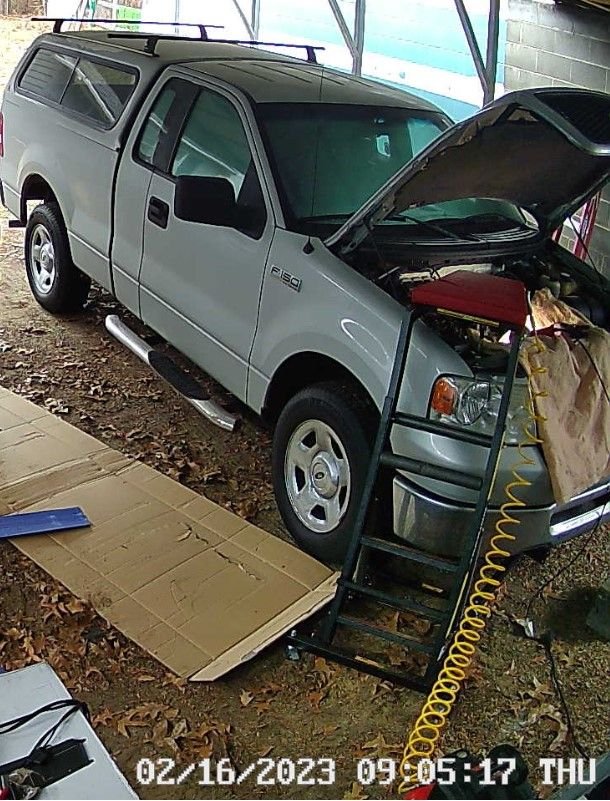

7 down one to go. $767 later.
Whenever I drove or even thought about my 2007 F150 with 7 counterfeit COPs installed, I felt sick, betrayed and personally contaminated by eBay. Sure, they worked but for how long and when were they going to fail? Well, I'm kind of back where I started, which is an improvement. At least all 8 OEM Ignition Coils now. 7 of which are actually new. I purchased them from the Ford Dealership. I told them my story and they were very generous selling me the 8 coils for $37.07 each. So, my loss of $181 from Ebay + $317 for Ford OEM COPs and $269 for the TopSide Creeper. A total of $767. I'm sure the dealer would have charged me something near that to do it and if I had to choose again, I would have the dealer do it. But hey, I got some good scratches, and experience on how my truck works. While I was at Jim Hudson Ford, I decided to take a look at the new trucks. $93K, 99K and 102K were some of the prices I saw. Beautiful but more than 2.5 times my original mortgage. So, I comforted myself on the fact that in December of 2006, I bought this truck brand new for about $24,500. It's worth the TLC I give it and it's worth continually investing in.
A mix of counterfeit and original OEM COPs that I've removed. A total of 14 COPs
The Horror
TopSide creeper was painful to buy but it actually made access much better.
