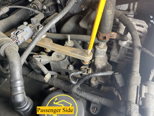

I am planning to replace the 8 Ignition Coils on my 2007 F150 XLT with 4.6L.
There are rails that run above the coils and I was wondering what they are and if they can stay in place while removing the coils?
Thanks in advance for your advice.
2007 F150 4.6L passenger side above the Ignition Coil
Old Aug 25, 2022 | 12:45 PM
Silver07's Avatar
Posts: 182
From: West Columbia, SC
I am answering my own question. The COP devices (Coil Over Plug) are able to be removed without removing the rail above them. On my 2007 4.6L F150 I used a 7mm socket to loosen and remove the retaining bolt on the COP. A slight tug pulls the whole COP out of the well and off the spark plug.
