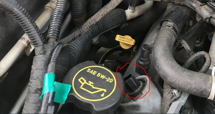

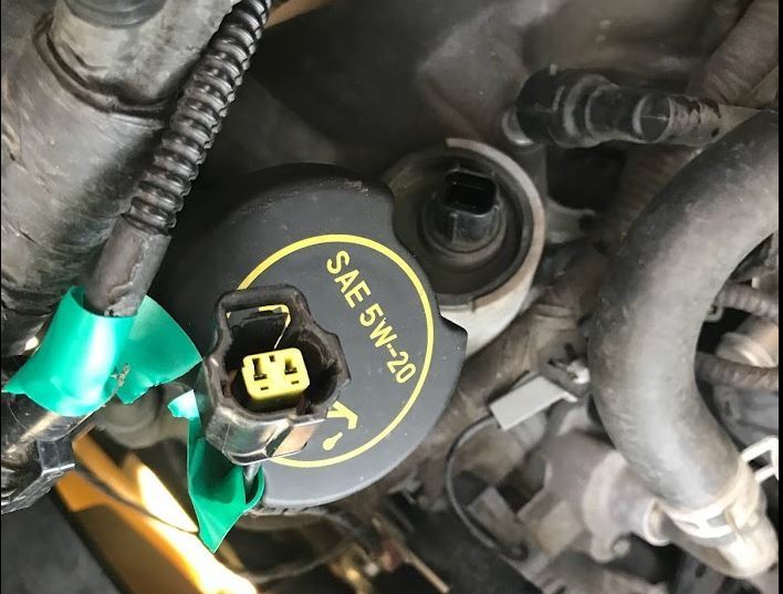

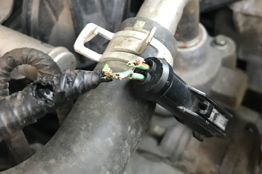

I went to start my 2004 F150 (5.4 V8) today and had a charging system light (red battery) and a CEL. It started and ran ok. I popped the hood and found a mouse has chewed through two wires. I am looking for some assistance on finding the right replacement parts.
1) This wire comes from the battery positive terminal. The part that is chewed goes into a round connector and branches off to another wire. I have attached pictures of the connector and the location of the wire. I think it may be a starter wire? These are named Battery#
2) This wires goes into the engine into a round plastic piece. I think it may be a diverter valve? These are named Round#
I put some green electrical tape temporarily around the chewed areas for reference.
Battery
Round
Old Jan 31, 2022 | 05:29 PM
Time to cut that plug off and then whip out the soldering iron, some nice leaded solder, and fix it by extending the wires and soldering it all up. Of course use heat shrink to cover it all up.
At least the mouse was nice enough to give you some room to work.
Old Jan 31, 2022 | 06:04 PM
bigcanoe's Avatar
Joined: Aug 2015
Posts: 13
Yes sir, that is my plan! One is chopped right at the plug so I am probably going to buy a new plug for that. The rest I will solder up and shrink wrap and tape for good measure. I just need to find the right connector(s).
