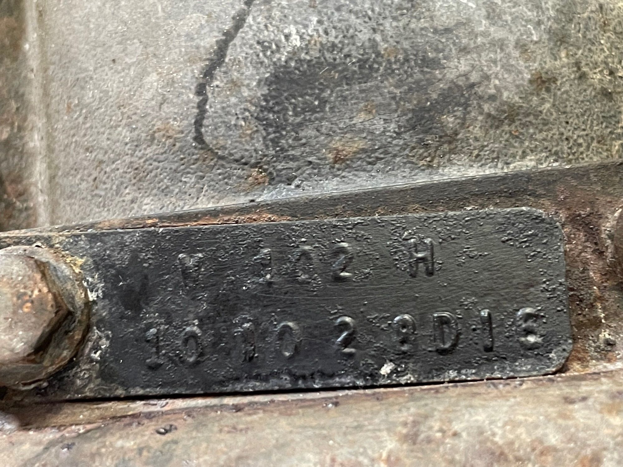

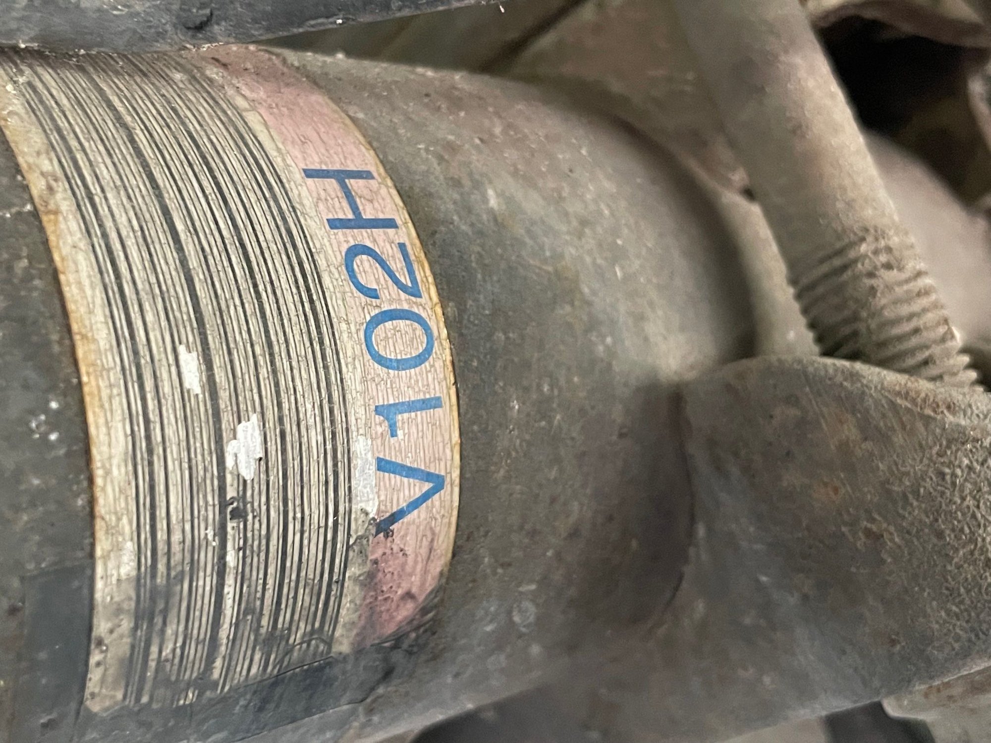

I got under there and the right tag says:
V 102 H
10 10 2 8D16
I have included the picture as well.
Tag picture are of the same tag... just seeing if you can see it better. And the sticker is in the right rear axle.
Any advice? Again... I am trying to find the right drive shaft for this vehicle.
Old Aug 6, 2021 | 10:56 PM
Posts: 43,542
Likes: 819
You have a 10.25" axle. You may have to go to a driveline shop and get yours rebuilt.
