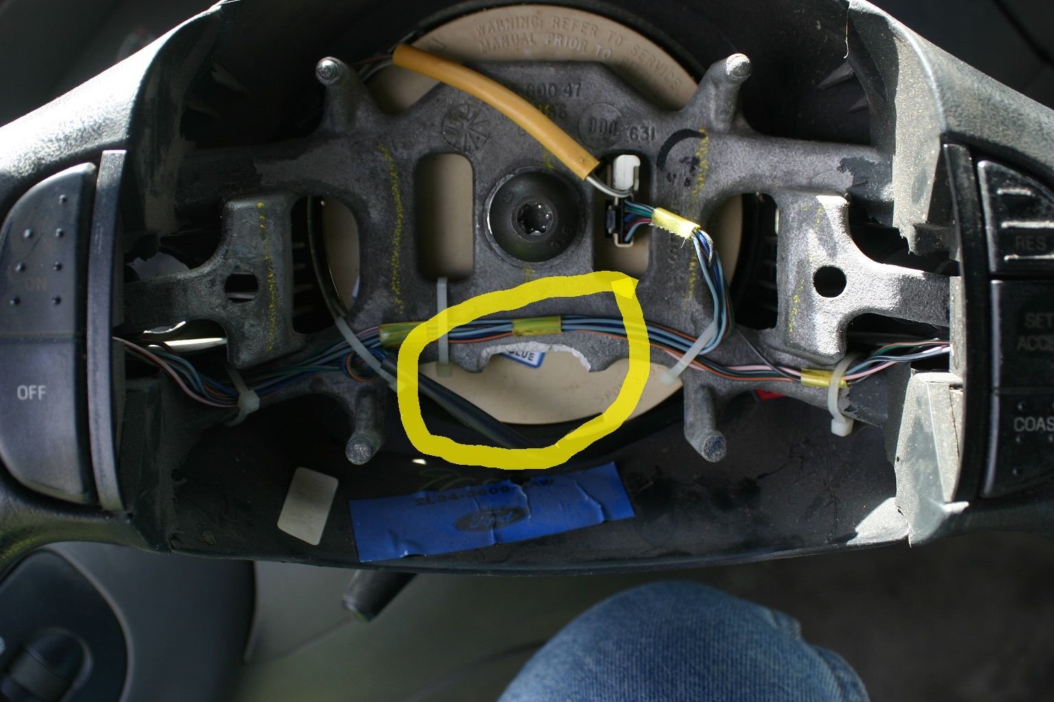

A 2-jaw puller used in attempt to pull the steering wheel.
Picture shows the results.
The T50 bolt was lossened several turns and used for the puller to press against the shaft.
Has anyone encountered this? And if so, how did you remove the steering wheel?

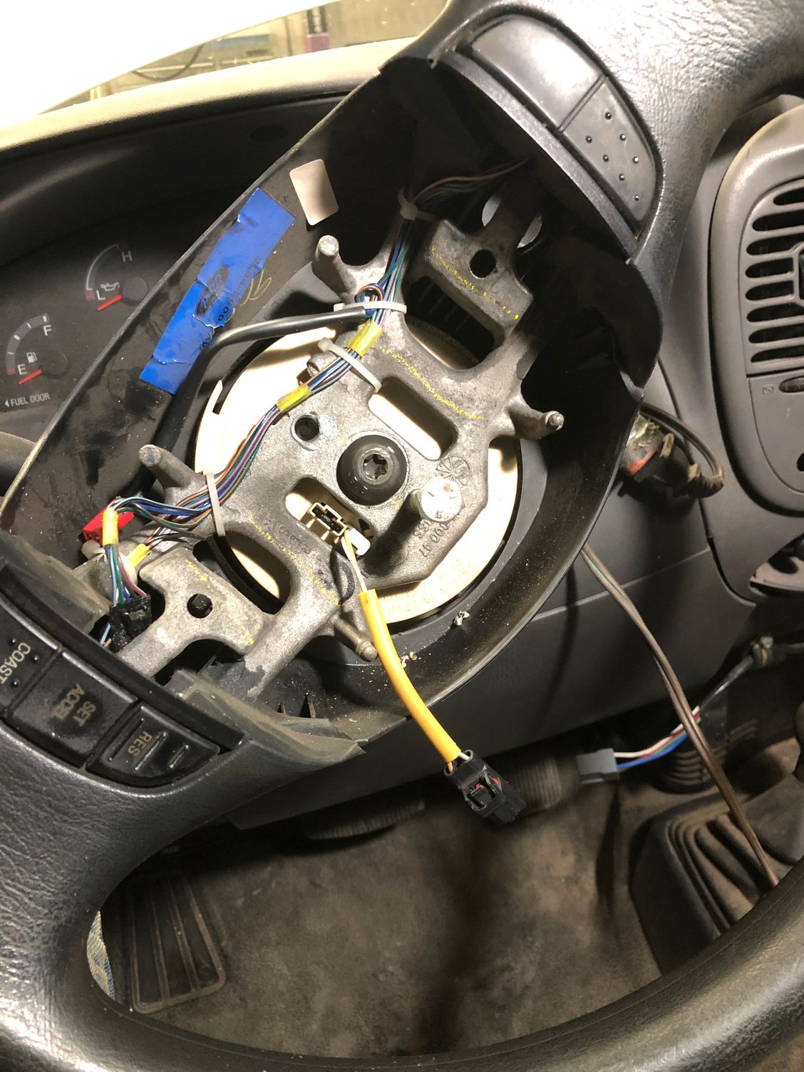

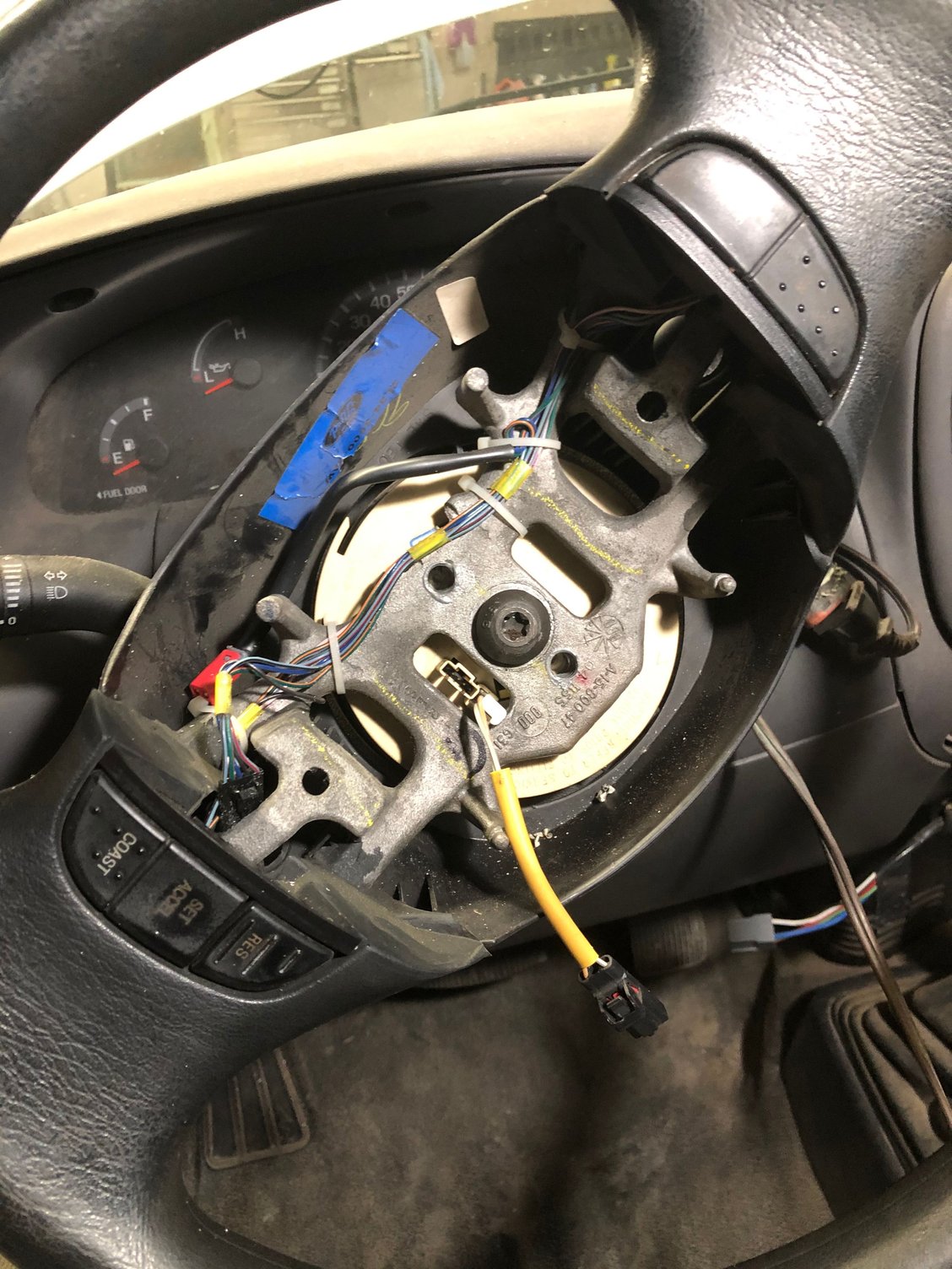

I drilled and tapped the steering wheel frame about 1 inch either side of the Torx bolt - 3/8-16 tap.
A carbide bit works best in the aluminum casting.

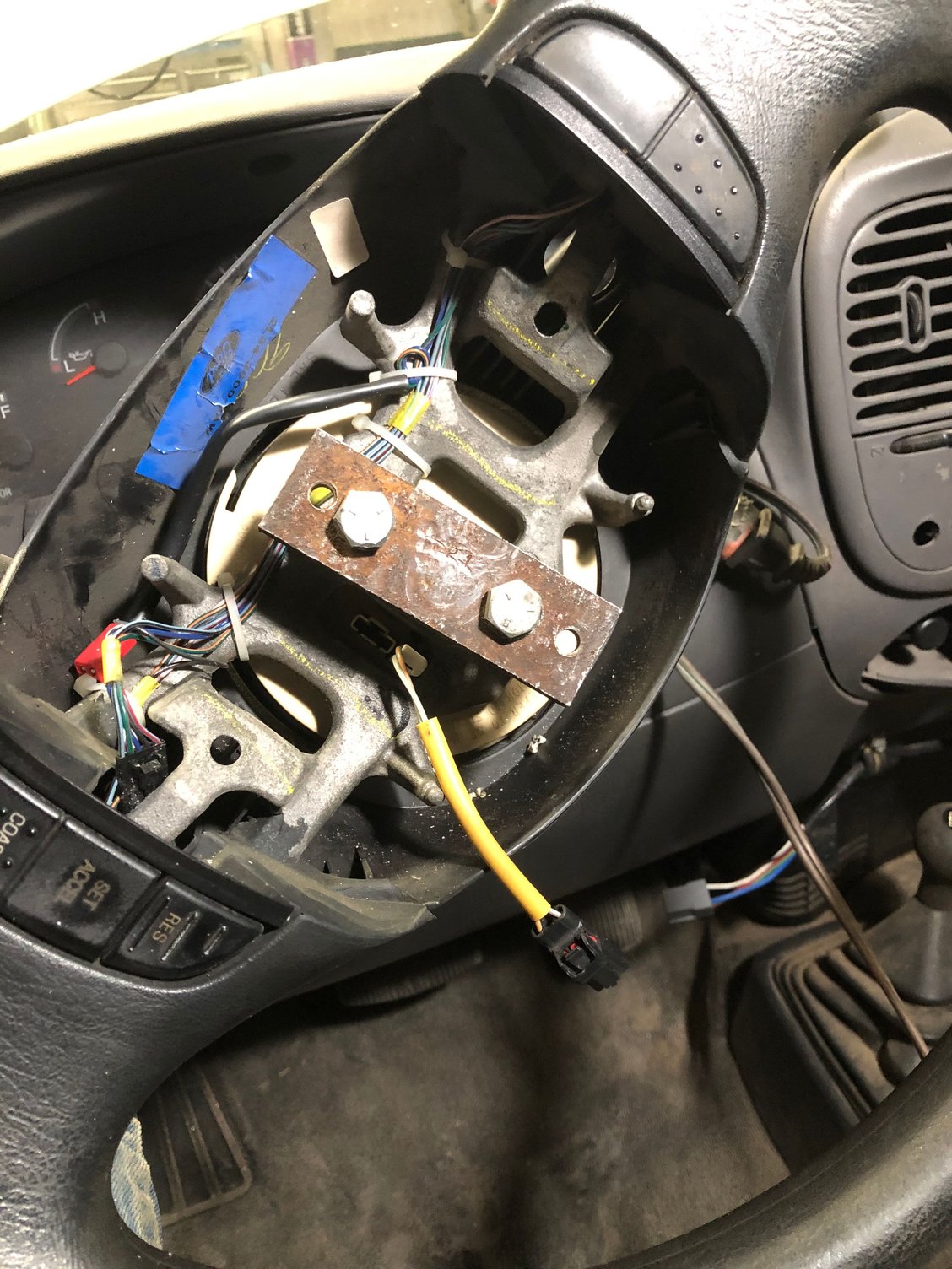

A piece of strap steel drilled to match - 2 3/8 bolts, and a small socket under the strap on top of the torx bolt.
I gave it a shot of penetrating oil, and after tightening the bolts, I still had to use an impact hammer to finally break it loose.
Two bolt holes across the center is the way old steering wheels used to be pulled. I attached some pics.

drilled and tapped
one 3/8 bolt
puller in place
