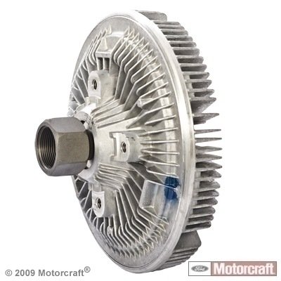

I'm looking at the fan clutches on amazon.com, and the OEM Ford MotorCraft is over $100. The Hayden unit is about $50. Electric fan set (you get 2 fans) is about $30. Electric fan controller is about $30.

And, I'm seriously thinking about the MOTORCRAFT fan clutch from AMAZON for $100.12.
Again, I REALLY do appreciate your input. But, I live the simple life now and all of those days of modding things are behind me.

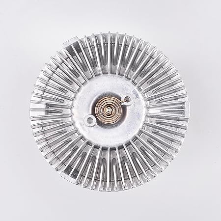

You're doing the labor. Same amount of work involved even if you sourced a less expensive part. You can always take a chance, buy the least expensive fan clutch, and return it if it does not satisfy you. @$27, it's a huge difference in price.
