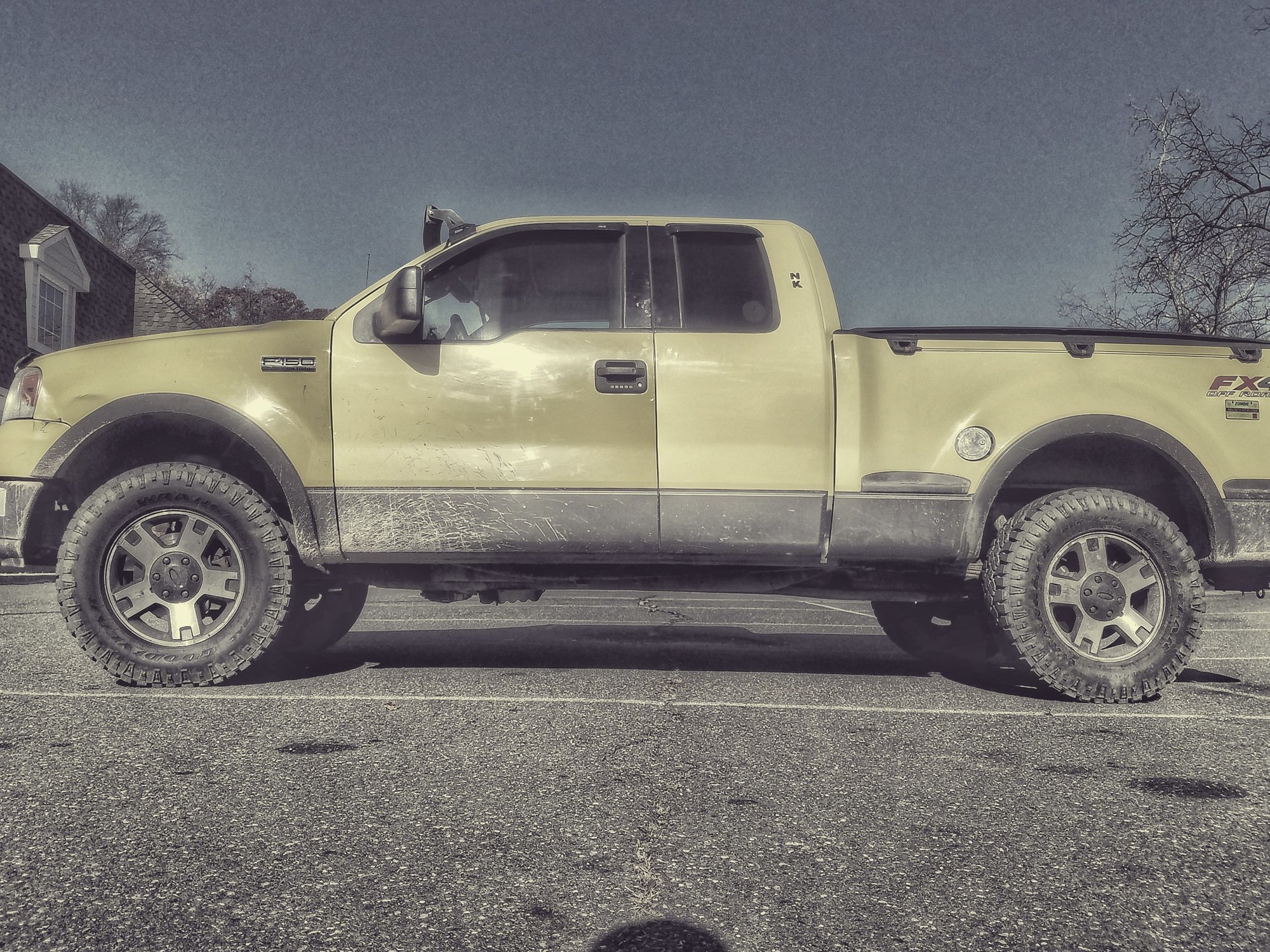

2004 5.4 F150 fx4 sscrew Flareside
Blazing Yellow
137k miles
34" Goodyear Duratracs on stock 18s
2.5" suspension.level. (Bilstein 5100 ride adjustble)
