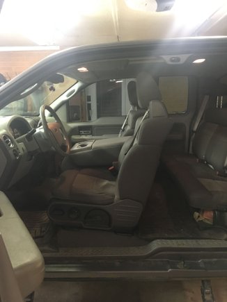

so I bought a 2015 seat, brackets and bolts. And, it all worked out quite well.
The distance between the front and rear floor studs must be longer on the newer models. So I had to slot the holes in the mounting brackets, I spread them wide and bolted my new seat in.
