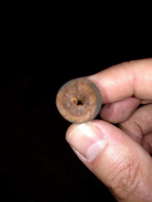

+1 to checking the brake booster line(s). I had this issue with P0174/P0171 codes and a sucking wind sound coming from the driver side of the engine bay. Took me ~9 months to figure it out (mostly I ignored it and actually found it accidentally).
I break in this line would also affect your 4WD (if equipped) and your ability to brake fast. Had a few close calls where I was nervous that I wasn't going to stop in time, even slamming the pedal down as hard as I could.
The rusted metal tube in the blue square has a small nip on it that is under the electrical connector at the red arrow tip. The red circled hose is what is supposed to connect to it. Second picture is how the nip rusted through and fell off INSIDE the hose, lol. Had to cut the hose, then reattached.
Your leak might not be exactly where mine was, but check that general area and all hoses leading off of that metal tube (to brake booster and to 4WD "parts and hoses").

Thanks for your time and specificity with the brake booster advice and photos. My husband's '98 f150 has been driving us crazy with the same hissing sound & slow-to-stop braking. He's outside now checking things out. Thanks again!
