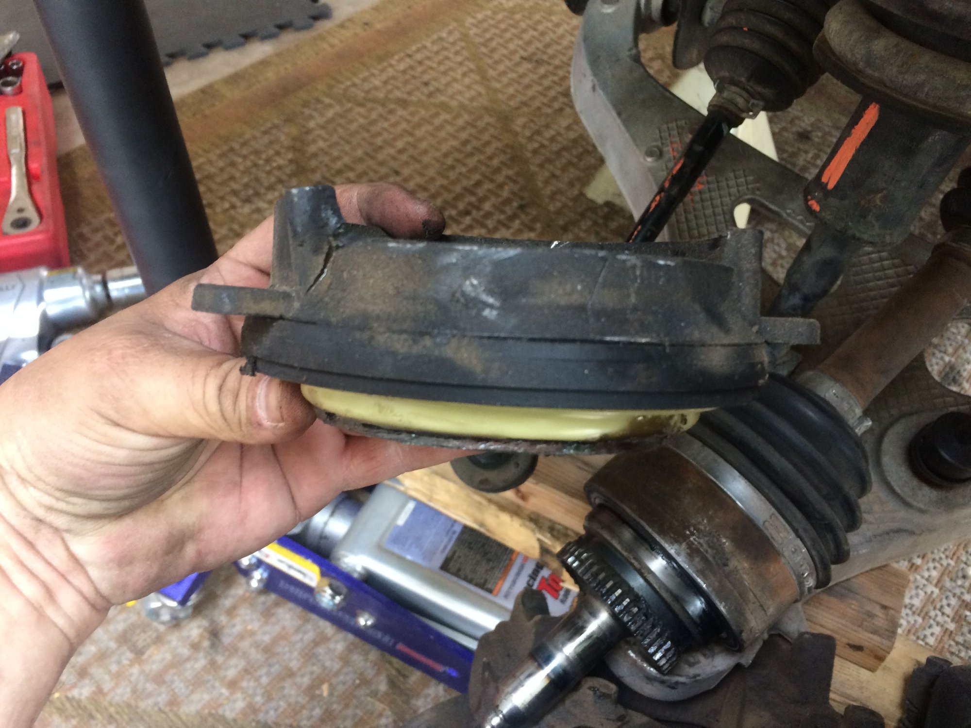

Kylevd23, I did not replace the actuator (I did not know what that was at that point). One thing I did noticed after changing the bearings on the passenger side, I could hear the noise on the drivers side. I saw that that the 4wd actuator on the drivers side was cracked in two places. I replaced the 4wd actuator and the noise stopped. Now when I switch to 4wd I can hear & feel the 4wd locking in. I jacked up the truck (truck on) and both wheels spin freely on 2wd & the wheels & shaft spin together on 4wd. before replacing the actuator, the wheel & shaft would always spin.

Not sure, here is mine below, I did mine for preventative maintenance, as I have read on other posts people not being able to engage or disengage from 4wd, so didn't want the same thing happening with winter coming, and it was pretty old. But you can see from the picture the corrosion and stuff it is exposed to over time.
