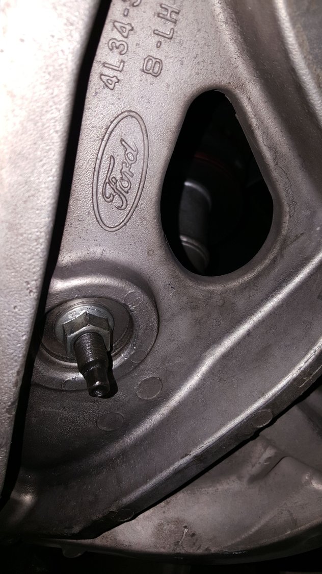

Ok here's the setup.The top nut abou the washer is just spinning. I'll put a jack under the A arm and apply some pressure but if that doesn't work do i have the spindle off?
Also, on the bottom u der the A arm, do i hold the 8mm hex and turns the 18mm nut or is it the other way around? What direction do i turn?
Which way do u turn it
Old Mar 17, 2017 | 09:56 PM
Posts: 43,538
See the hex just below the lower washer? That's what you have to hold still. Both nuts come off counter-clockwise.
