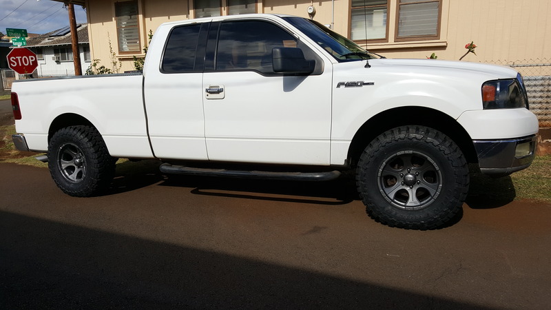

had 2.5 AS level kit on since I had the truck back in 04. Mine is a simple XL, but she still running strong. Currently run 33x12.5x17 all around.
