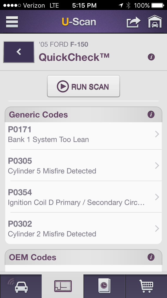

So without troubleshooting further I just went ahead and changed the number 4&5 COPs. Truck seemed to be running well, until we just took a 2 hour trip up to the airport. Truck started to shake again and MIL came back on, I had brought the scanner with me and attached a picture of the new codes. Additionally I noticed the the truck has a stutter or hesitation on the highway at mid-throttle letting off or giving a little more pedal will smooth it back out.
Check for vacuum leaks. Run a couple bottles of Techron through the gas, you may have dirty fuel injectors. The 2005 5.4 did have a bad batch of injectors from the factory, but they usually leak or stick open giving you rich codes.
Wouldn't hurt to pull the #4 and #5 plugs and look at them.
