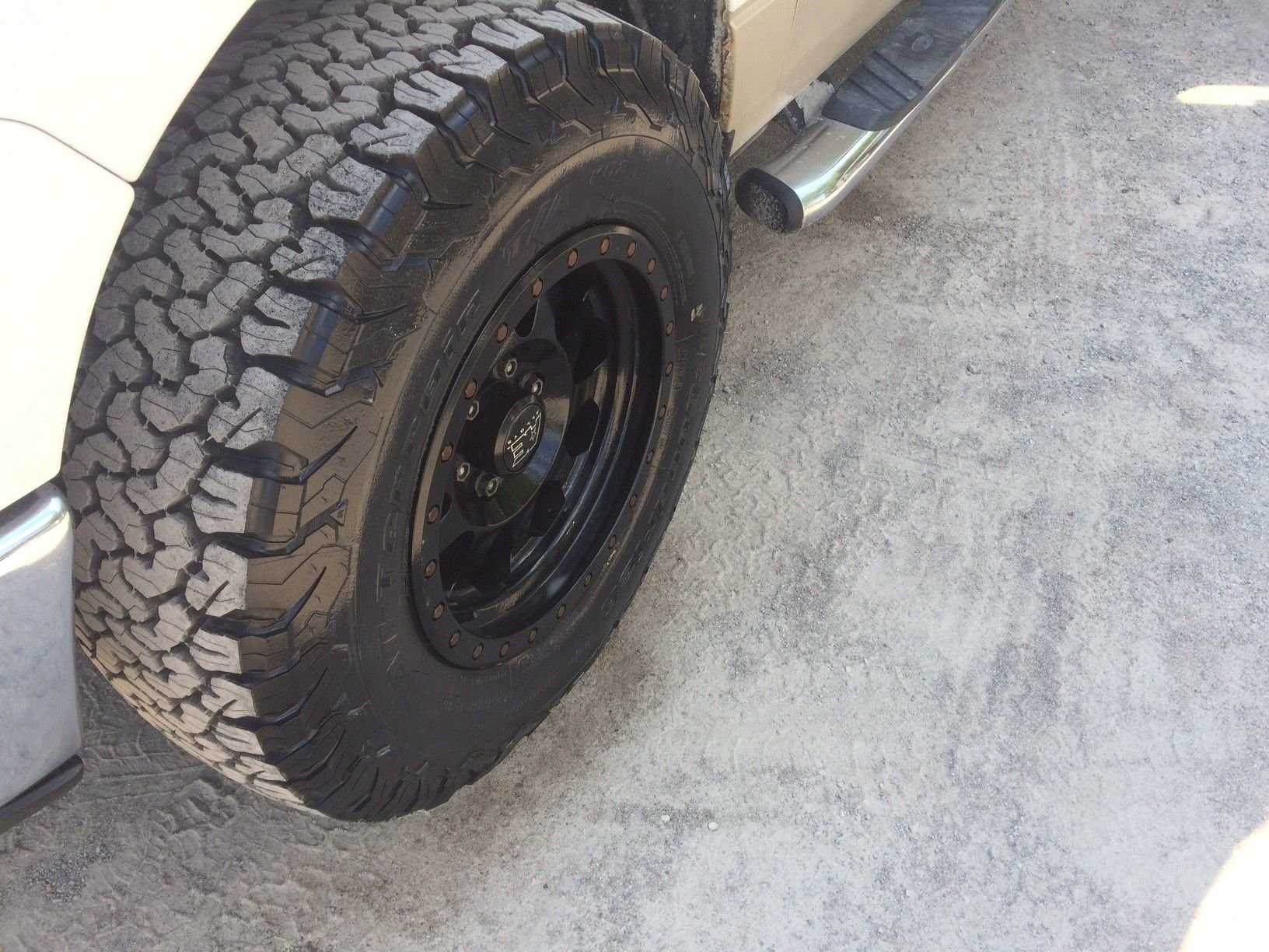

Here is what I am running and this is what it looks like
These are 33's as far as i know
Part # Size Lug Pattern Offset BSM Load Weight
0128-8993 17.0x9.00 6 on 135 8 5.257 2500 29.3
with a Tire of 285/70/17 BFG k02's
Hope that helps, no lift, no rubbing
