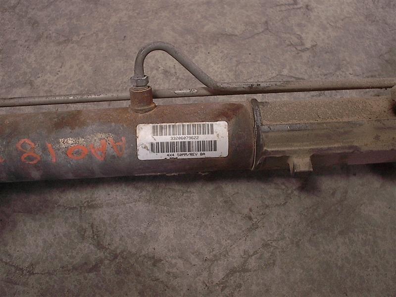

Hi, I am a new owner of a 2004 F-150 FX4. Bought the truck with a leaking power steering and I have isolated the root cause of the leak. It is coming from the "transfer line" attached to the center of the rack. The top portion has simply rotted through. I have searched the forum and google for about a week and only found one thread where someone actually asked about replacing the hard line on the rack. Unfortunately, no one chimed in with a part source and all my searches only come up with a HP line or Return line....no hard transfer line leading from the rack to the gear box.

I may have sourced the part. But the picture of the part in the link appears to be longer than the part I need.
http://cardone.com/Products/Product-...ductId=3L-1207

Looks like bulk brake line that you can get at the auto parts and bend to fit.

I have a double flare tool. I guess I will have to make the line myself. Considering we have snow on the ground, I can't take it off til a few days from now.I guess my next question is; Is this a standard double flare end?
