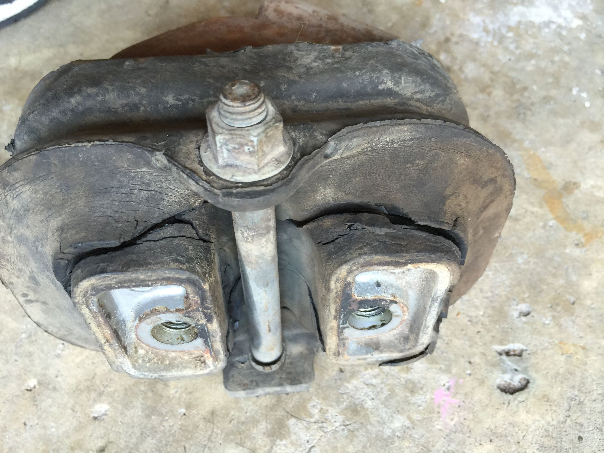

Got the motor mount out today. Would have gone faster if I had not tried taking off the pass side exhaust manifold. For those doing this, drop the y pipe, take bolts from trans mount, take ac compressor off and push out of way. Take off starter which was a pita then lift motor and wiggle out mount.
Here's the old one. I hope it cured the squeaking

Problem SOLVED!!!!!
