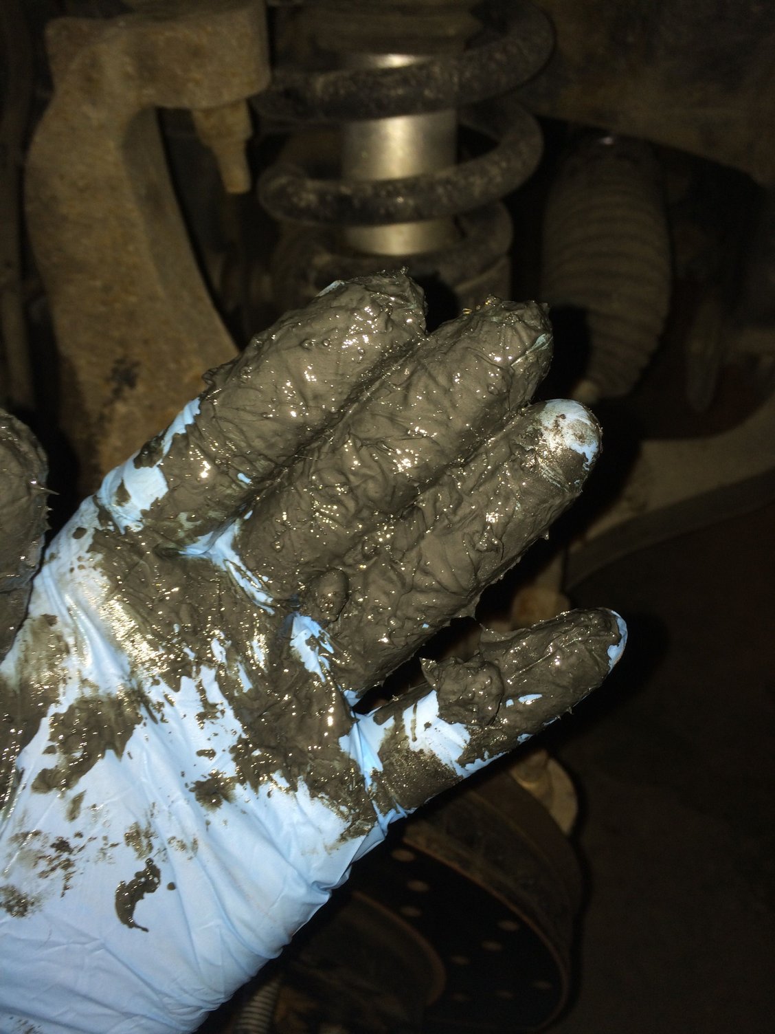

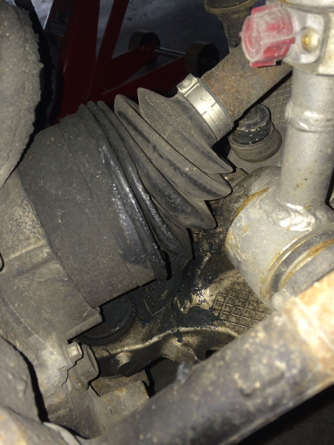

Took my wheel off today because I noticed grease splatter on
The rim coming from behind the wheel.
My driver side is spotless, but passenger side has thick globs of grease all over.
I know the boot has grease on it looking like it's leaked but some is from
Me running my finger around it looking for a split, I never found one

Its cv boot grease. Will last a long time unless you get water in it. May just have a pin hole in it. Change the whole axles when ya have the time and money to do it. It will make a clicking noise on turns when it runs out of grease. I have seen these last a year like that!

Grab each axle shaft and try to shake and move it. If there's any play in it, replace it, the CV is shot.

Yep that's it. Has about an 1/8 inch of play in it and the drivers side was solid. Thank you all for
The assistance, gonna swap it out after work tomorrow
