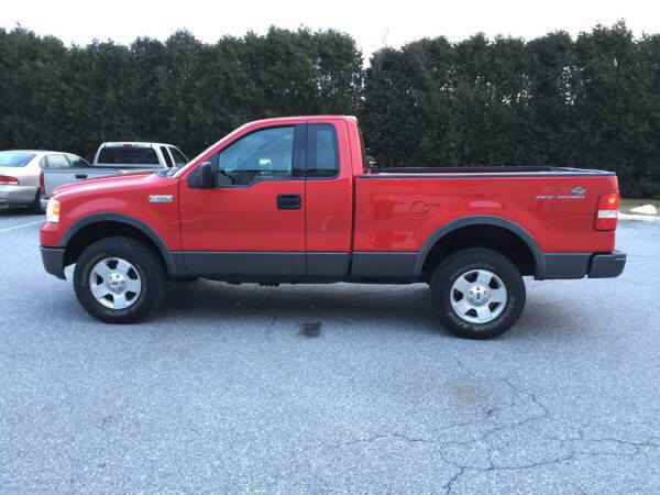

I know it's 11 years old, but this thing is in great shape. 5.4 reg cab fx4. Not a spot of rust, even the rockets are rust free. Runs great, but all the parts are original. Most fluids, plugs, suspension. I know Id need to spend a bit for preventative maintenance, the plugs may break (128k on it). $6000. Was thinking about getting it cause I could really use 4wd in the winter. Bringing my xl back to stock height, small oe size summer tires and keeping it just for better mpgs in the summer.
Worth it? Or just sell my truck and get a newer 4x4? Problem is, I'll never find something used in as good of condition as my xl and I enjoy not having a payment.

Don't be surprised if it ends up being a $9,000+ truck. There is a lot of potentially expensive stuff that may need fixed ( IWE's, phasers, timing chains, guides, tensioners, VCT solenoids, FPDM ). In addition to all fluids, and the other maintenance items list I previously published. Oh - yeah ... them plugs, lol.....
I'd buy a good set of snow tahrs and throw a couple hundy pounds o' sandbags in ye XL, and save 6+ Large.
good luck
MGD

you can buy a LOT of gas for the $6k you'd spend on that track

Looks great.
Get some nice rims on and it's a winner.
Or do what Iam doing and pile $$$$ into it. Make it a little more swift.

Can't imagine having two of the same truck (aside from the 4WD). Either buy it and sell yours or just keep yours. I don't think you go wrong either way.

Exhibit A: The XL. 2WD. Fastidious, exemplary maintenance from Day 1. Complete records. Flawless.. Simple. 7 years old.
Exhibit B: The FX fer. 4WD. 3V. Complex. Unknown maintenance history (actually, NO maintenance, looks like). Records = ??? 11 years old. 128K.
Reckon ye can go wrong ....

Haha good points. All of them. Had a lot of snow this winter, and while I've never actually been stuck, I almost got stuck when the roads were terrible the other day. Luckily was able to back up and then gain enough momentum to make it. That's what had me thinking about a 4x4. I live in a snowy climat half the year and I have an open differential and no weight in the bed. I'll try 300# over the rear axle and look into the cost of adding a detroit Truetrac.
Just really like the look of that reg cab fx4. Worth it? The guy kept avoiding my question "have the plugs been changed" his response, "it runs great and needs nothing." Me: "I get that, but have they been changed?" No response. Ha. Guess that tells me something.

I have to agree with MGDfan here. I had a 2005 XLT 4x4 regular cab / short box with the 5.4 in it. That's pretty much exactly the same truck you're looking at - with a whole year of Engineering Change Orders to tackle stuff that didn't work as designed. I hate to say it here, but that truck was the biggest POS I've ever owned. The 5.4 was a never ending source of exactly the problems MGDfan has noted.
Yes, it's a sweet looking truck - and so was mine. Probably the best looking truck I've ever owned. It looked great in the dealership Service Department on many, many occasions. I'd stay away from it.
