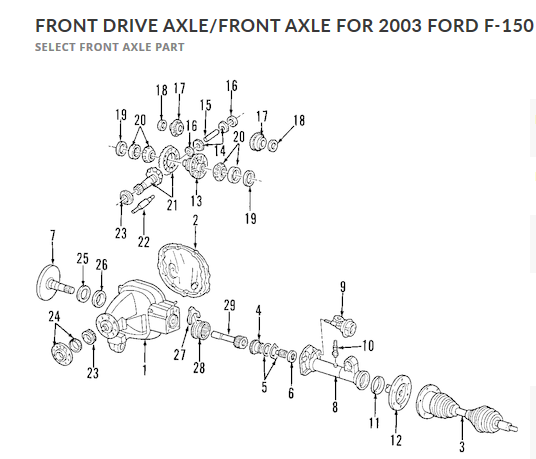

Old Mar 2, 2017 | 03:32 PM
N4VG's Avatar
Joined: Mar 2015
From: Hoover,Al.
water in front diff
where is the breather cap for front diff in 2003 F150 super crew FX4 ?
Old Mar 2, 2017 | 04:19 PM
Posts: 43,542
Likes: 819
Item # 10.
