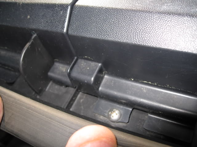

I own a 2007 STX supercab. The front cowl panel, or the piece between the windshield and hood, keeps popping up. It doesn't detach or anything but if sitting in the cab, the left side of the cowl pops up over the right side which it is attached to underneath. Does anyone else have this problem?
Old Nov 18, 2013 | 01:12 AM
Several guys put in a stainless screw that joined the two halves. I think there were even pics. This was a few years back. Use the search button, advanced search and see if you don't get threads on the subject.

Like this...never had another problem:
