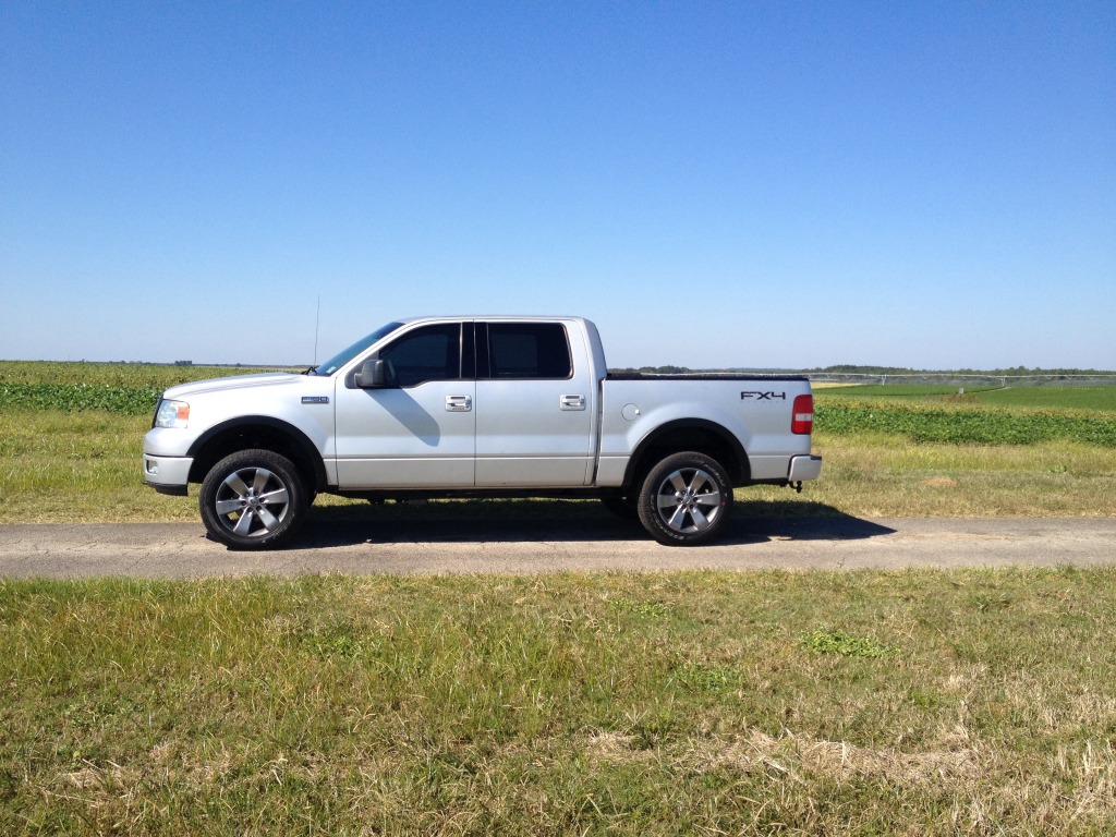

Old Oct 28, 2013 | 10:18 PM
Ha hey! That looks about level to me! And the freshly painted flares are gorgeous
Did the new FX4 decals go on nicely? Where did you get them from? Those look great too. You're 09+ mirrors and fender badges away from a fully "updated" truck.
And I just noticed the door handles. You've been busy! Did you remove them and have them professionally painted?

I sanded, primed, and painted them myself! They came out absolutely factory-standard! I have been looking around for badges, but it is beyond me to spend 100+ bucks on 3 badges. So I will keep on looking. I got the stickers off amazon for 20$. They went on easy enough, had a few minor bubbles on the passenger side but not noticeable.
Took new measurements yesterday, and the thing is level to an eighth of an inch. Some guys on another forum found that if you werent satisfied, the stock springs have a heavier rate than rancho's. They swapped the springs and gained almost an inch.
As for my case, either I took bad measurements, or the truck fairy lifted the front for me.
