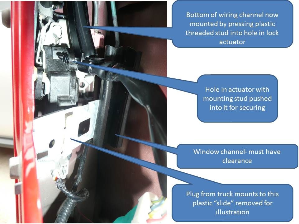

I got tired of waiting and went back out with a fresh mind.
Did not take too much mucking about until I decided on my routing
I am happy and confident that what I did will work - I took some picture so that others can see what I did.
Note that I am a rank amateur - this is what I did- follow at your own risk
[img]
[img]
[img]
[img]

before and after
[img]
[img]
if you can't tell my truck is RED

perhaps a better view through a "composite" photo
[img]
