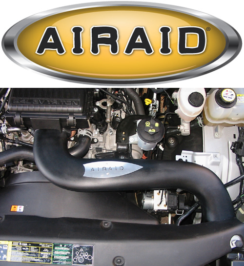

sure is. replaced mine with a air raid mit #400-940. I did it too clean up the look under the hood.You can hear it when you get on it. sounds like a 4 barrel carb. As for performance there is no noticeable difference i can tell.

I have some store credit with one of the vendors, and plan on going with the Air Raid intake tube. I like the idea of keeping the stock airbox / my K&N filter setup.
If you can find the ABS plastic pipe, that might be well worth trying though. I know PVC is plenty brittle compared to ABS, so it might produce better results.
If you want to get rid of the baffle, some guys simply cut it out. It is just connected by small plastic tube type airways. Just cut it clear and plug them off.
I haven't seen any actual flow numbers on any of the rigs out there, Air Raid or otherwise, but considering the OEM tube necks the 3" down to something around 1.5 to 1-7/8" max, the airflow from the Gotts mod itself has to be substantially higher, Not sure about the actual ducting dimensions, but the Air Raid tube appears to have cleaner turns, and a huge horn like snout, all good things for making air flow the way you want it to. If it makes the intake sound like a 4BB carb, big whoop de doo, as long as it doesn't produce a big drone in the cab you are good...
