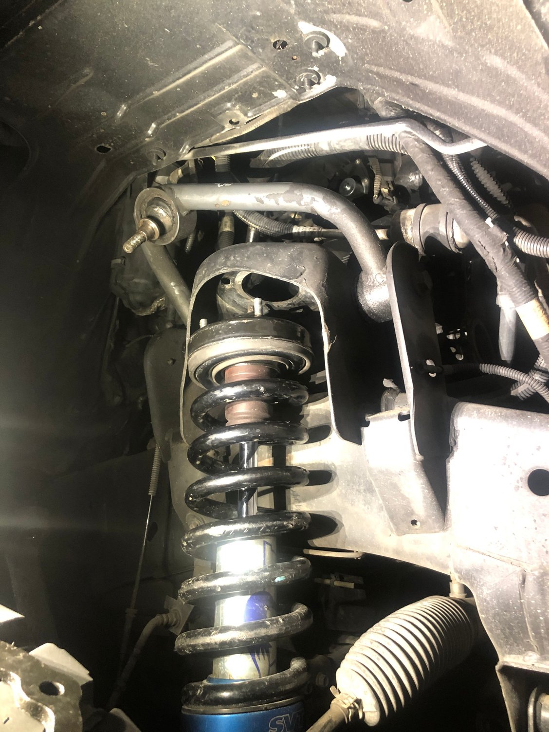

Old Apr 15, 2020 | 11:22 PM
vasallo13's Avatar
Joined: Aug 2019
Angle space bracket 04 f150 raptor gen1 swap
Originally Posted by Quicklx50302
Did you use the two Piece cast iron spacers that kicks the bottom of the shock out on the raptors to give it the proper angle to correct for wider track width of the raptor suspension? If you did I would guess that you stacked them on top of each other than you installed the shock into the frame pocket. Using those spacers would give an additional 7/8 of an inch lift.
i try this who thing. And I’m so confused as how those spacer go on the truck. When I install them they make the top hat tilt to the front. When I run with out the the top hat tilts to the inside of the truck. It seems to compress the spring a bunch. Anyone know how that’s suppose to line up???
