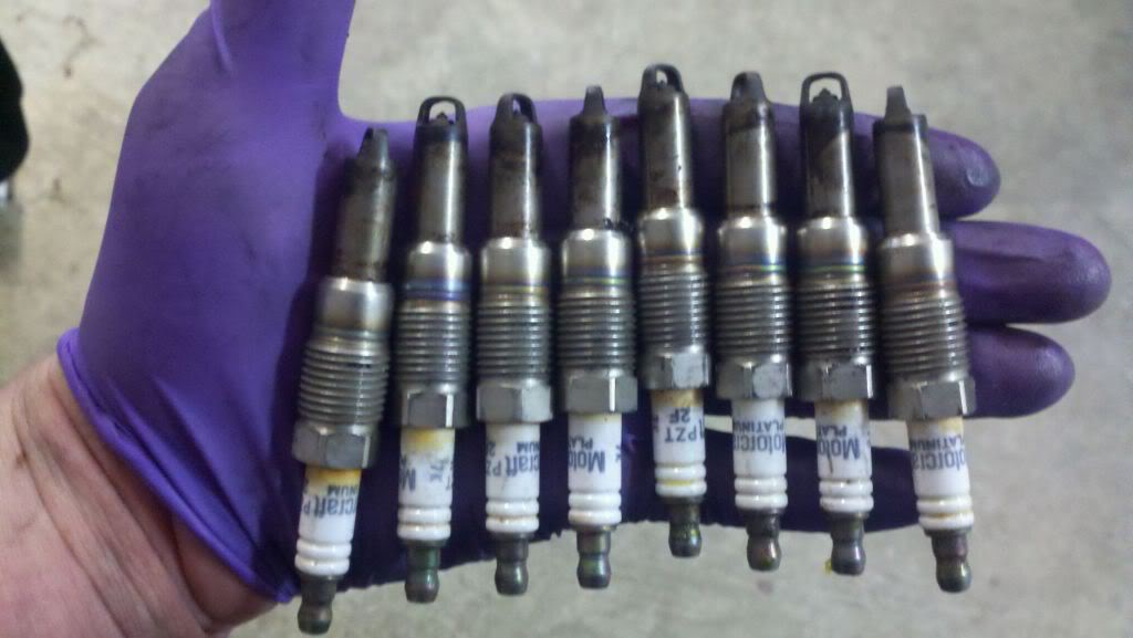

I did i have mis in cyl 1, and on cold start up i can smell like the truck is not burning fuel. (running lean)
The noise sounds like a clicking or ticking when there is more then half throttle(or under load).
No hesitation in response or bogging. Just that noise.(some mite have it)
I started with changing the plugs last night(non broke, thank god) but the pre detonation is still there.
so tonight, im gonna pull the injectors, and let them sit in injector cleaner over night. And change the fuel filter.
If this doesn't work, i will move on and change the injectors.
*Update* possible carbon build up??? im gonna try the sea foam carbon break up stuff. Run the whole bottle in the gas tank.
pix of old plugs. black tips, and smell of fuel from not burning right.

Think your chasing the old boog a boo. Phasers and chains and the Ford service memo of parts to put in. You're mnot too lean so a vacuum leak is probably not. You have no codes for retarded camshafts? Pinging is a rattling and detonation is a really bad sound. Detonation will break pistons, while pinging will burn them. Burning 91 or higher octane gas really isn't required by ford. It actually caused more problems. I would decarbon, or get back to 87/89 octane gas. Unless you pull really hard loads a lot with hot weather. After you change gas try some 5w30 oil. Are you blown? If so, check your intake tube for a crack.

As I began to realize you may be blown, I came to the realization you are very lean. Looking at your spark plugs they are stainlessly clean. A normal aspirated motor woul have carbon. I would change the tuning to a more moderate spark advance. If you have a code reader that maps PID's in graphs during real time running look to the timing. Check your fuel pump driver module, fuel pressure and filter for problems. If you have changed your exhaust to a very open dual system and cold air intake would mess things up also with the gas you have. If you find nothing enhance your gas with octane booster and see if it helps. A way to raise octane is propane injection or other injection process other than nitrous. Your in a serious situation of motor life, you certainly don't want to run leaner. A long time fix is to slow down the blower to a more sustainable boost. You may already have some piston erosion, things are heating up on you in there. I would keep the motor at an even torque not pulling it down on hills etc. One way to lower temps for summer is a 140 degree thermostat if you are doing shorter 10/20 mile trips. On a longer run the motor will still probably heat er up. If desperate, I would add a qt of diesel at the fill up, that would slow up the pre-ignition. You are kinda doing the Seafoam thing, lubing the top cyl area, just cheaper. After that I would use a couple ounces of it to even out the fuel, looking to tuning and fuel injection/Blower mods to ease up the thing some, unless you find better octane remedy.
