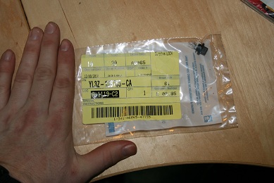

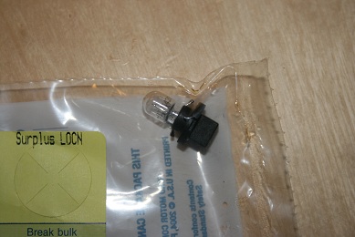

The light bulbs for the back of the speedometer/odometer are P/N YL3Z-13B765-CA. They look like:
My hand is in the picture for size comparison.
