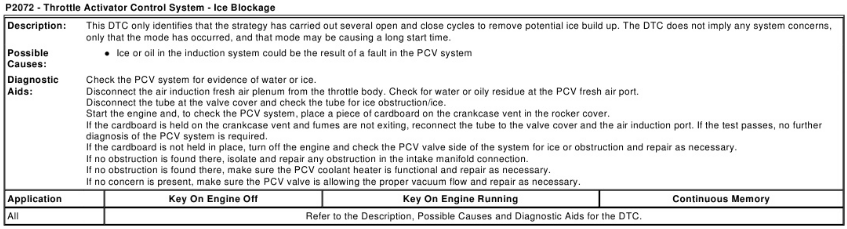

P2072 - Throttle actuator ice blockage.
I've trimmed down the descriptions, but you get the idea. I've picked up a new spark plug and COP for Cylinder 7 (second from rear on driver side, right?). I've also picked up a new battery, since mine was not holding a charge.
I'm hoping that by fixing 7 my mileage improves a bit. I'm running about 5-8mpg lately. Also, any thoughts on that last code? Not much info I can find on here about it.

So I found some information elsewhere on P2072. Doesn't look too bad, just a longer start process. We've been down to -50C over the last 2 and a half months, so I can see an ice blockage ...
