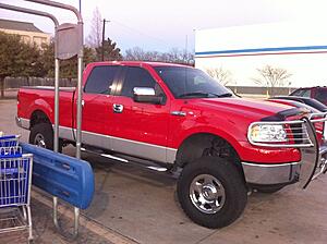

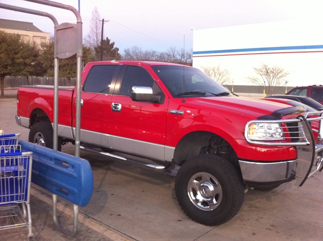

saw this at academy the other day. i was rushing so i couldn't really take a look to see what lift it was or if it was even 2wd, but heres a pic:
2wd w/ 6" lift and oem wheels with 35s-jjjna.jpg

thanks for the picture. I knew it could be done. Now I am just trying to come up with the funds to make it all happen.
