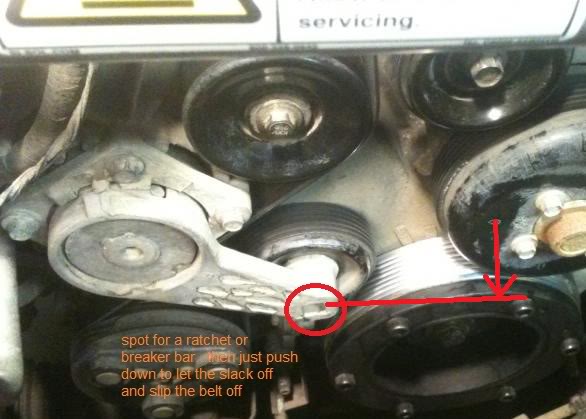

Oh its easy to change. There is a spot on the belt tensioner for a 1/2" (i think its half inch ) ratchet drive...All you have to do is put a ratchet in there and take the tension off the belt and it comes right off. If you dont have a sticker on how the belt goes back in place take a picture so you can put it back in.
No i live in red deer, used to work out of whitecourt and was in GP lots for work too.
this is your tensioner and what i was talking about
