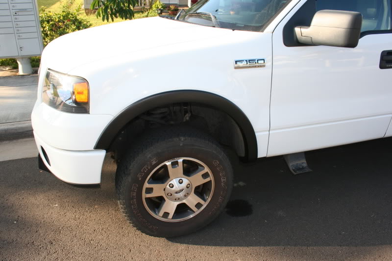

take 'em off and paint them black yourself
I did it on my 06 FX4. It's pretty easy to do so. I scrubbed them really good with a hard bristle brush, some Simple Green cleaner, and then used Krylon Fusion Plastic Black spray paint.
came out very good...but then I traded the truck in 2 days later
and they are truly black after that...not some pseudo gray/black thing
I think I spend about 3 hours of time and maybe $15 in parts. pretty good trade-off IMO vs. buying new
removed:
installed after paint:
