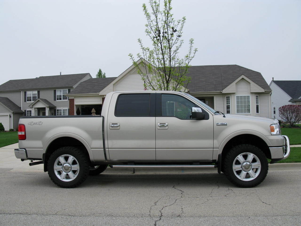

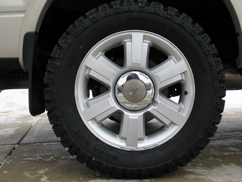

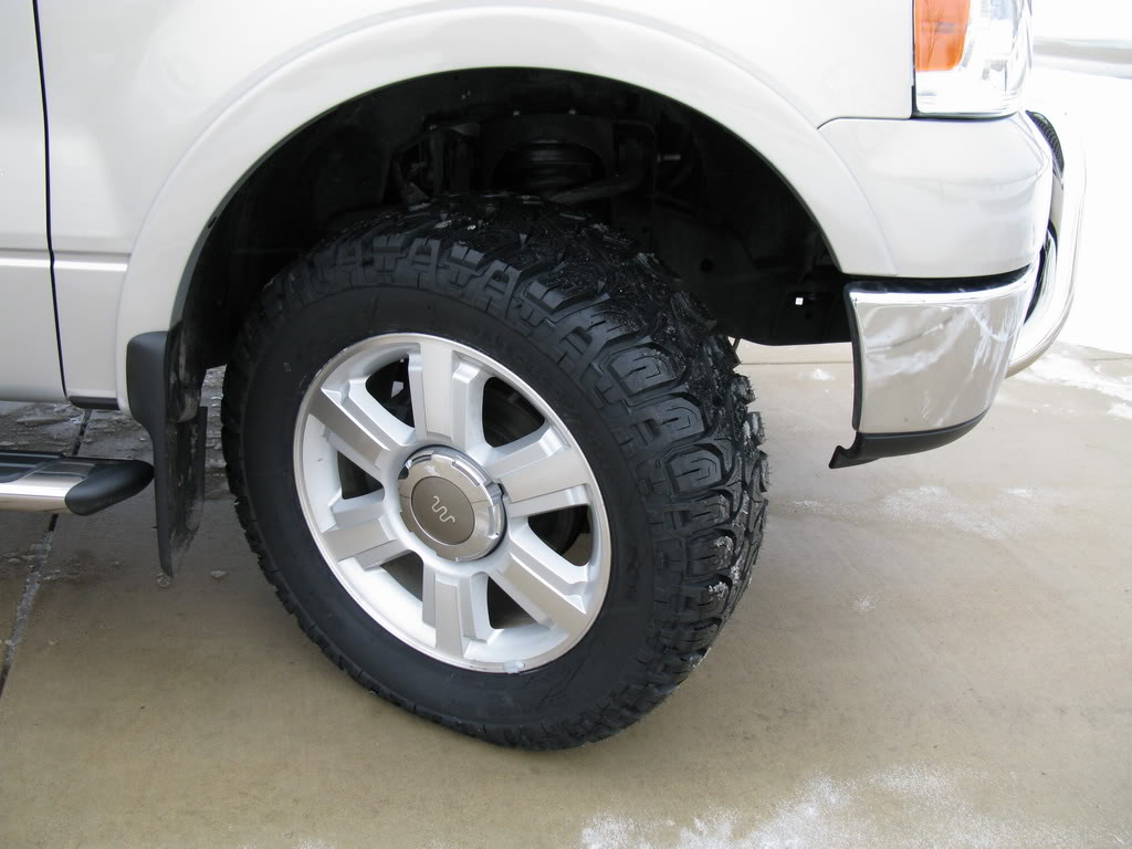

I went with the Mickey Thompson BAJA ATZ in 305/55-20 on OEM 20's :

Yeah, those pics help a lot. The Roush offset is with a 1/4" of Fords but the same width which also what I wanted to see. I had checked out your pics in the link before, but the angles in these pics above are what I was hoping to find. I like the stance of your truck. I have a 4x4, but the front is lifted about an 1" and the rear lowered about an 1".

rms8, have you experienced any rubbing on the control arm on hard turns?

No rubbing unless you turn the wheel all the way to lock, then the sidewall just ever so slightly makes contact with the UCA. I find the only time one would ever really turn the wheels so dramatically is in a very tight parking lot. I have lived with these tires just over a year and aside from the highway noise (an unavoidable evil with AT's) I am 100% pleased with them.
IMHO, the 305/55-20 is the IDEAL size tire for a leveled 04-08 F150. Anything taller or wider (or worse, both) is too much tire for the height of the truck. It makes the tires look "ballooned" a bit too much.
