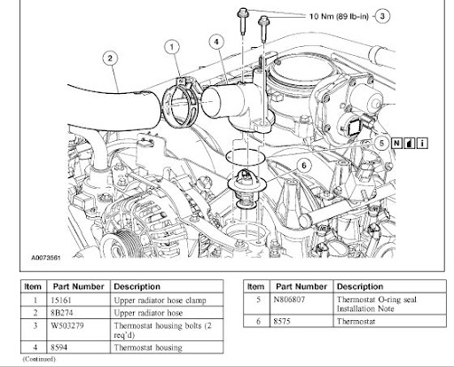

Here you go Pat:
Run to the autoparts store and get a thermostat and some antifreeze. The thermostat should come with the gaskets. Then let the engine cool down for the pressure to bleed down.
1. Partially drain the engine cooling system.
2. Remove the air cleaner assembly.
3. Remove the parts in the order indicated in the illustrations and tables.
