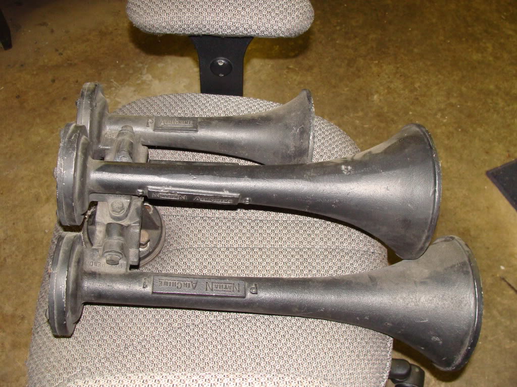

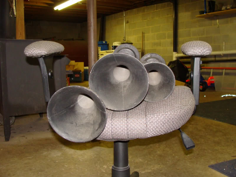

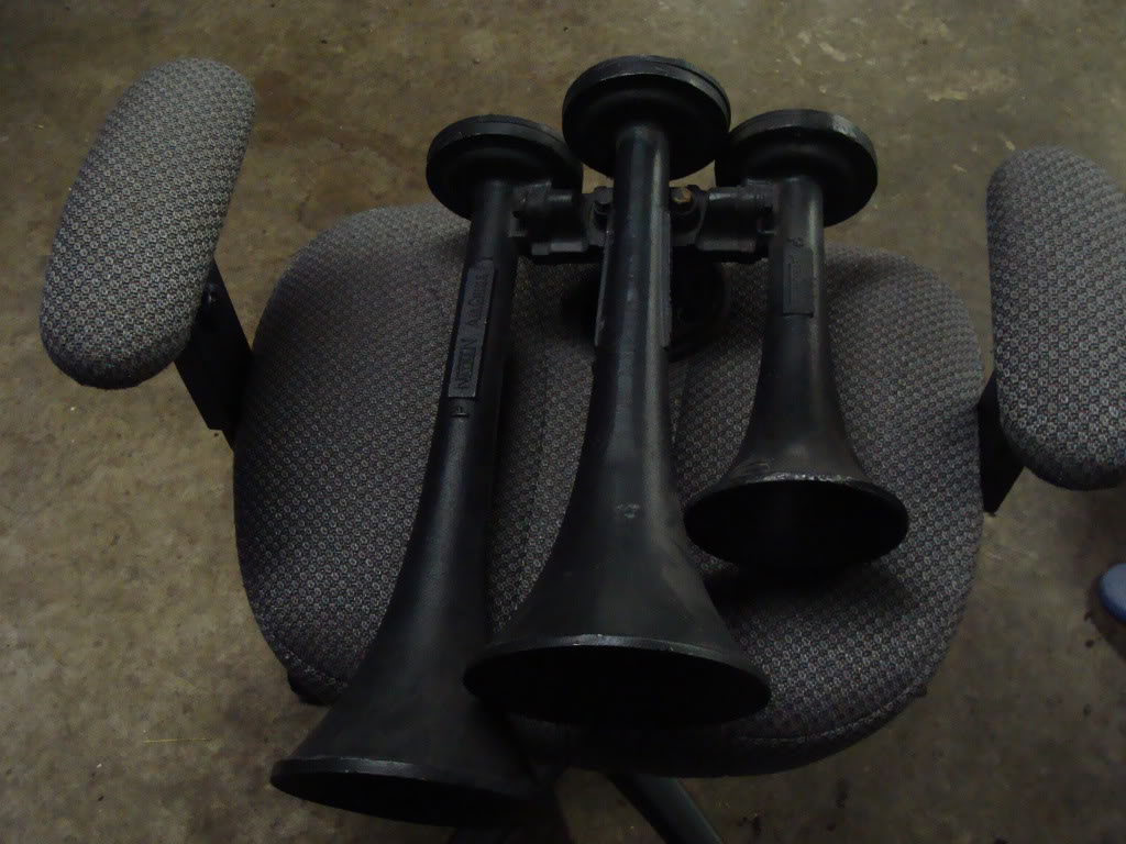

I recently got a dual 480c Viair compressor kit and i have a 5 gal tank that I don't have pics of yet. I know everyone says the best place is spare tire but i kinda wanna keep that due to pulling a travel trailer. I looked at putting these beast behind the grille but i just don't think i can the tank i just don't think will fit on the frame rail so I figured that will be where the compressors go i did see a spot above the rear axle but i thought about suspension compression and I don't want any thing to hit i only have a 5.5 foot bed and i use a lot of the bed when we go camping. I am running out of options anyone have a good idea for me any help and pictures of custom installs would be great. I found some really good prices on air zenith gauges and i am planning on getting a pod for the center of the dash. I did a search but alot of what i could come up with was spare tire, spare tire so i thought i would show some pics of what the horns look like.
