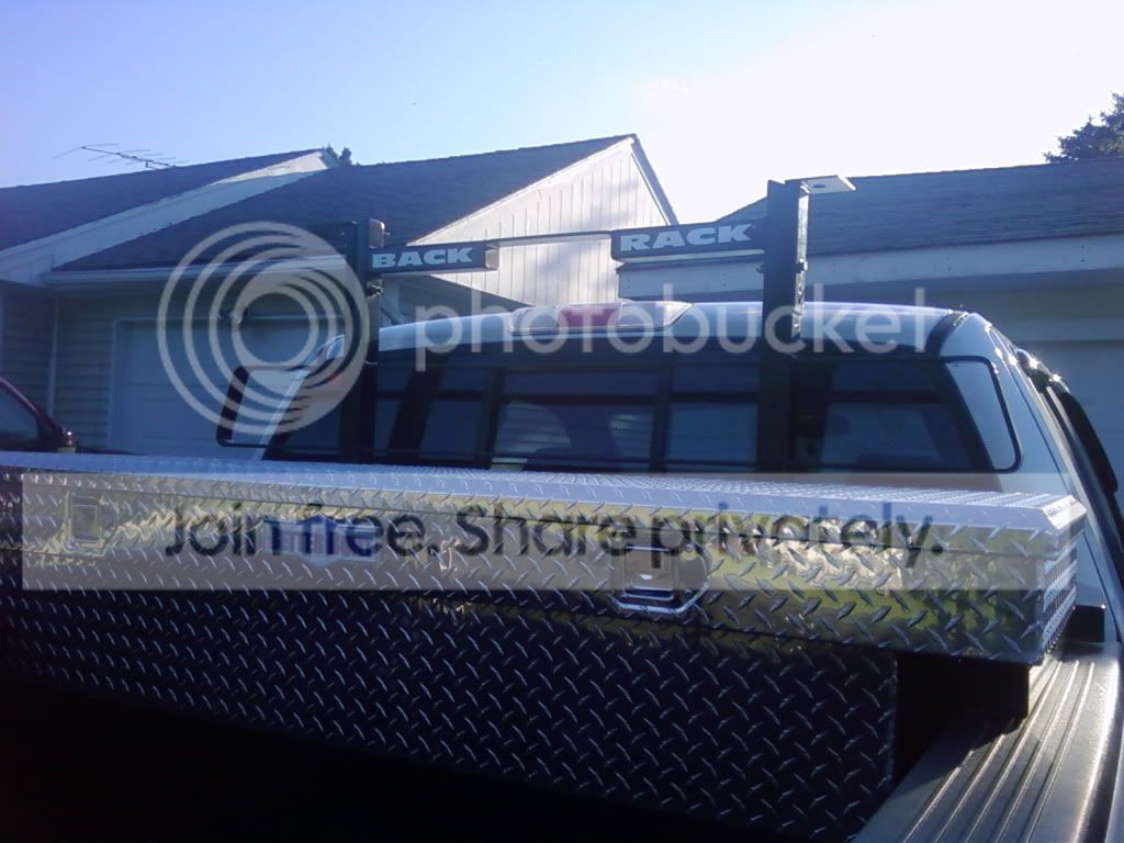

And the answer is..... No. Not without modifications anyway.
I put it on there, and the hole pattern compared to the stake pockets was about 3-1/2" narrower, So I drilled new holes in the backrack to get it to mount to the f150 width. I also had to drill new holes in the toolbox mount brackets on the bottom, apparently the stake pockets are also about 6" further away from the cab on the f250 then on the f150.
Anyway, I got it installed, but it doesn't look very good, yet anyway, the top tube sits about 4" taller than the cab, but I don't have the energy or resources to get it changed at the moment, so I'm just gonna run with it as is for now.
How much can I complain though, I got it for next to nothing, just traded for some plastic toolbox brackets, a steal even if it doesn't fit quite right.
Sorry if the image quality is bad, took it with my camera phone.
