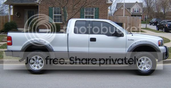

Well I completed an additional mod Friday evening...after the Daystar 2.5" Leveling Kit installed last week, the truck really sat up in the front, so I wanted to do something to the back. I chose the Firestone Ride Rite Air Helper Spring setup and I'm real impressed with it thus far. The stuff is QUALITY, the install was no-drill on the F150, and we ran the air lines out to my license plate for a nice clean look. I'm running 30lbs in each bag, it leveled the truck out well, and the ride is awesome. When I tow, I'll be able to keep the rig level...and I love the stance. Firestone Ride Rite gets an A+ from me. Good stuff! (I may have to get the in-cab controller/gauge and compressor to make it slicker in the future.)
Before the changes:
After the Daystar 2.5" Leveling Kit on the front (+wheels/ugly tails):
After the Firestone Ride Rite kit on the rear (-ugly tails):

More Shots...

Tight work...........

Looks good Brian. Want me to park next to it so you want to lift it??
